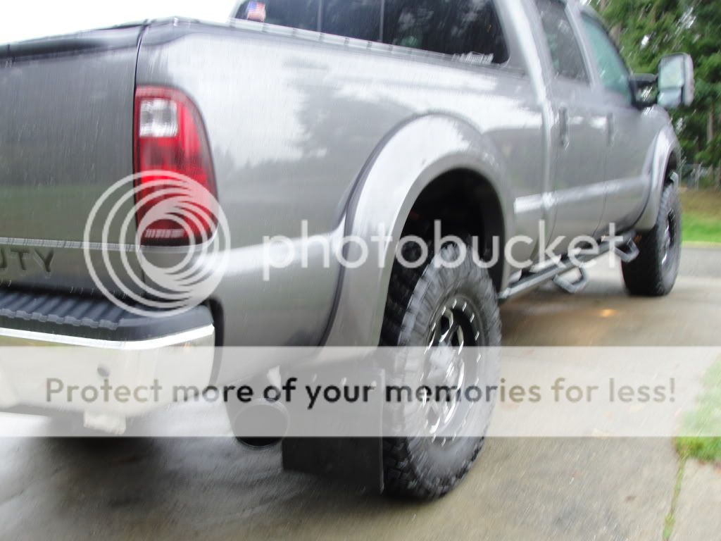

MBRP, AFE, and a few others make a DPF back kit. I have the 5" MBRP kit with a 6" tip.

Didn't void the warranty. It only replaces everything behind the emissions equipment (or a delete pipe if you do choose to void your warranty). I haven't really noticed a change in the sound. The truck is still very quiet unless you add a delete pipe.
