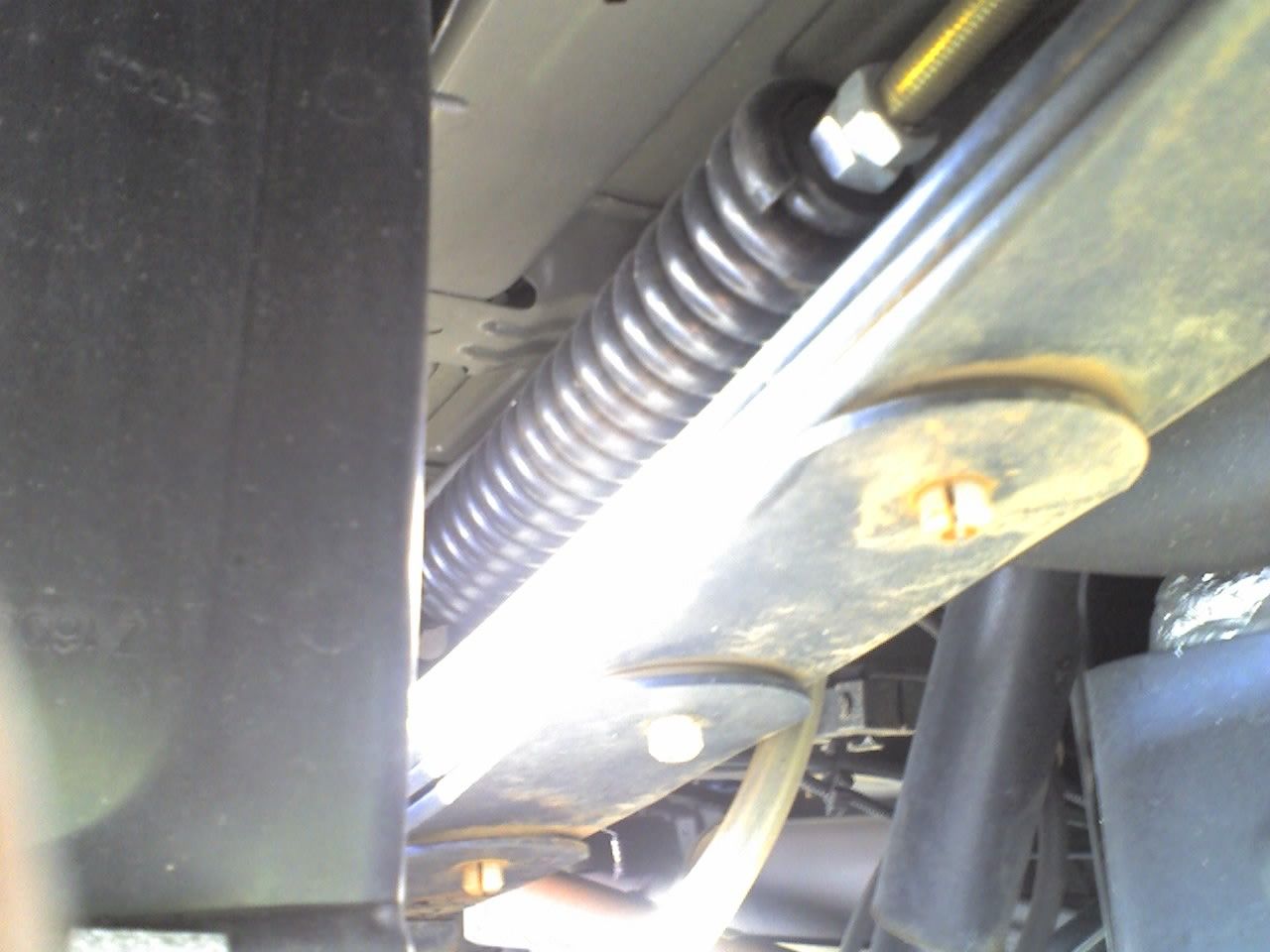

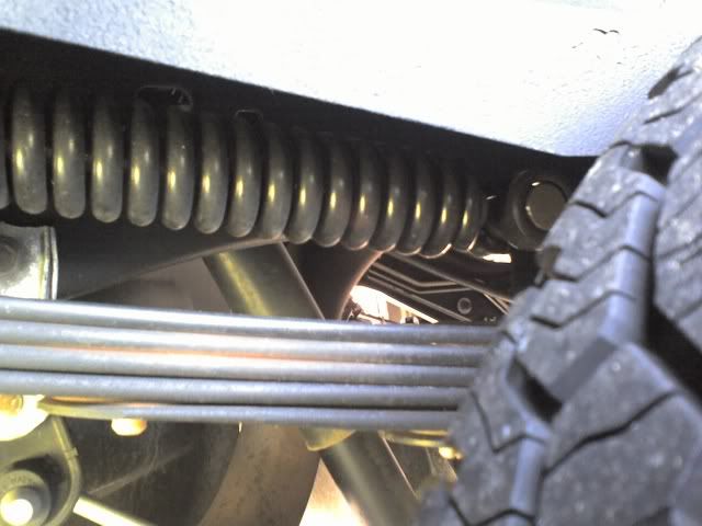

Okay guys..here are some pics. Had to shoot of the RAS due to the wheel house being in the way.
Drivers side...
Passenger side...
