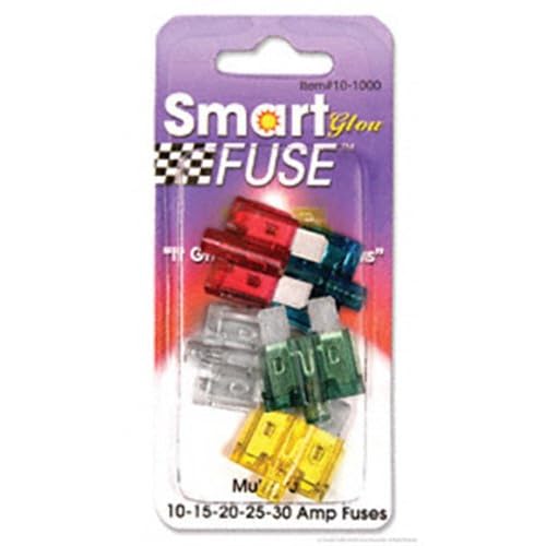

ya know....they make blade fuses that illuminate an LED bulb
when theyre BLOWN...makes it easier to SPOT a blown one...not
that *I* would ever need such a product...nah not me ;)

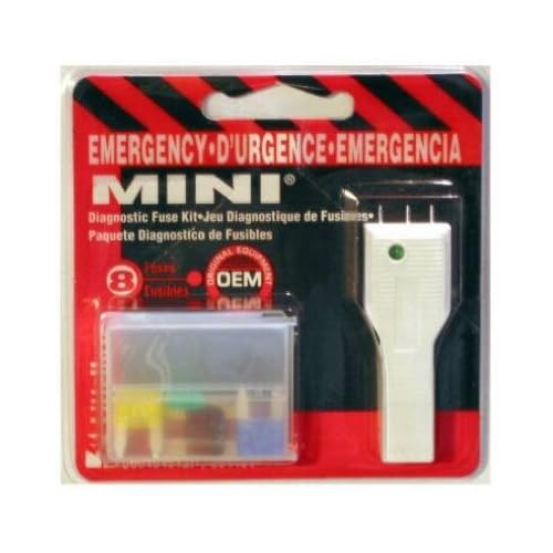

also some of those fuse KITS have a little plier like tool that
pulls the tiny bastard fuses and on the other end it has a test
LED...got one of those too, myself...but i STILL needed (and like)
the fuses that light up when blown.... SMART GLOW FUSES <LINK>

Alright now i feel even dumber. The two fuses that were bad were ones i put in there with little lights on them. My thinking is they lite up to help you see in the fuse box, NOT to tell you they were bad!!!!!! Too funny!!
