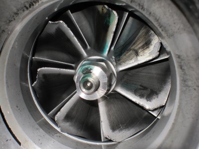

There is evidence to suggest K&Ns are bad for turbochargers. The reason being is they flow more than they filter. All filters have to balance flow against filtering. K&N has roots in racing, and in racing, flow beats filtration. Unfortunately this is not the case when you have a turbocharger. Flow is of course important, but letting too much dirt by can damage the turbo wheel, this is termed "dusting". Some people dont believe that K&N is to blame, and to be fair, okay, the evidence isnt concrete, but it does suggest this. But if its possible that K&Ns might do this, I choose another filter.
Below is an image of a severely dusted turbo. Unfortunately the forum this picture is from wont load due to a malware alert, so I cant report exactly what the problem was in this case.
