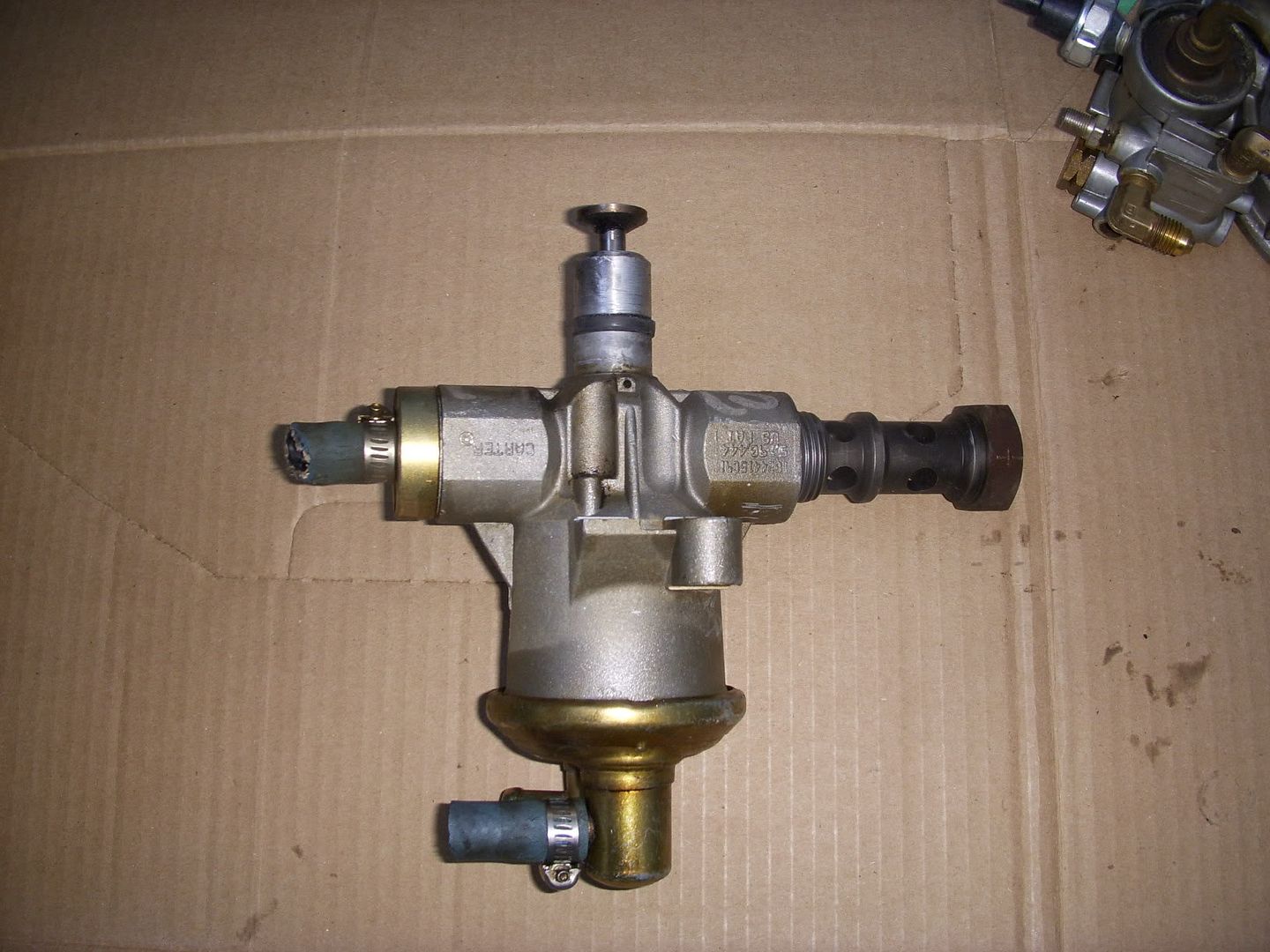

take a look at this image you can see the weep hole right at the bottom

BJS, thanks for the photo... now i know what to look for.
