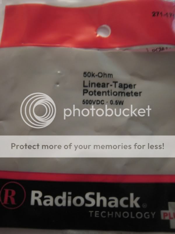

Found some pictures:
You can get a knob for the potentiometer from radio shack. I mounted mine next to the 4x4 switch. I'll try to get a pic tomorrow.
Here is the potentiometer
