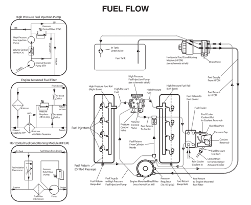

S Souser17 SDD Junior Member Joined Jun 15, 2023 Messages 4 Reaction score 0 Location Cincinnati Jun 15, 2023 #1 Can someone tell me does the unused fuel go back to the bowl and get reused from there or does it go to the tank and reused from there

DaveBen SDD Senior Member Joined May 31, 2005 Messages 9,663 Reaction score 92 Location Ukiah, California Jun 16, 2023 #2 It goes back to the tank and gets reused.

S Souser17 SDD Junior Member Joined Jun 15, 2023 Messages 4 Reaction score 0 Location Cincinnati Jun 16, 2023 #4 I have had people tell me it goes back to the tank and I have done a little research and found it does not go to the tank. It goes back to the fuel cooler and back thru the injection pump. If I am reading that diagram correctly.
