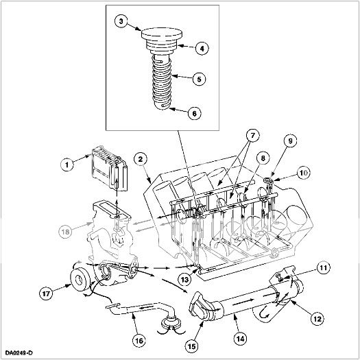

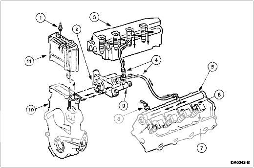

anyone have pics of this? Is the low pressure oil pump the same thing as the IPR or are these 2 different things?
dpantazis
#12
Nov 8, 2005
1,854
under the cheddar curtain
j:
2 different things.
the low pressure oil pump is 'inside' the engine like on other motors. its behind the water pump on the front of the engine and the hpop mounts to it.
low pressure system-
high pressure system-
iirc, its index number 9 in the HP system pic. ipr is a regulator very much like the fuel pressure regulator that you shimmed.
