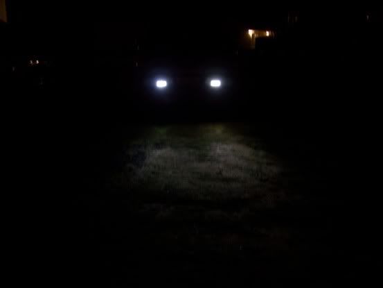

Night pics
Here are some pics of the LED's at night. Keep in mind, my camera is not the best for taking pics of lights at night. The lights are much brighter than the pics show.

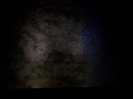

SIDE VIEW:
REAR VIEW:

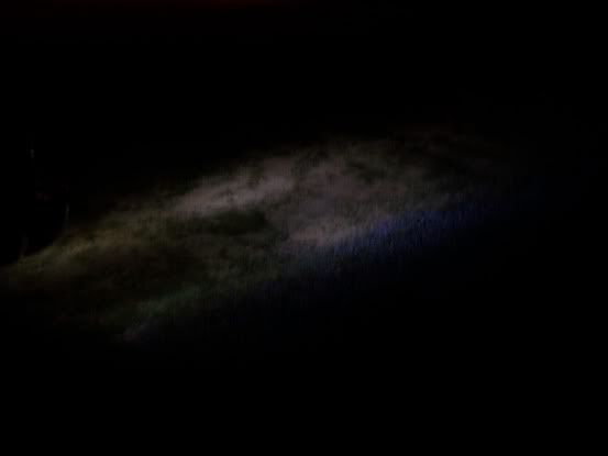

FROM INSIDE THE BED VIEW:
the reverse LED's look nice and bright...maybe its just the photos...but
it looks like the light is concentrated LOW and a bit NARROW behind
the truck...it doesnt look like any light is making it past the sides of the
truck enough to use these for backing up (lord knows you can see over
the tail gate @ night)
The set up would work well for trailer connecting/disconnecting and some
"working behind the truck" at night but I think the curve of the bumper
is such that its angling the lights down low...rather that getting the light
far enough behind the truck or wide enough to see.
I find that when backing up you need the light to be WIDE so you can
see out the side mirrors.
I agree bush. With this type of install, that was only place I could mount the lights and not get into the braces.
I have thought about adding some similar to yours in the future so to be able to see around the curve of the rear bumper.
