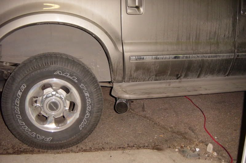

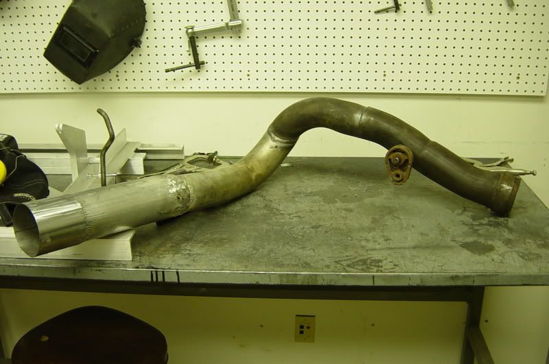

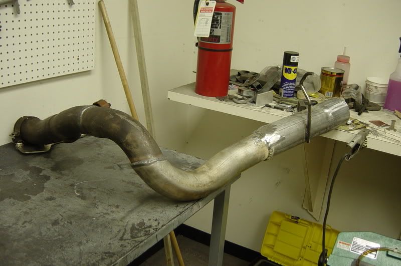

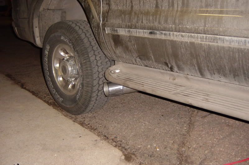

Ok so I got tired of the no noise coming from the X and dont have the cash to buy a system.I do however have free time at work and some extra parts from my old duramax and the stock sytem off the X from the muffler back and also from a 4" system I had on the duramax. So heres the finished project, I cut off the exhaust and all behind it, and used the short piece of pipe with the built in clamp and hangar for my starting point.Next I used 2 cuts of the pipe that goes over the axleto get y angles.Next I used the ront pipe off my old duramaxto exit out right.Then I added an extra piece of 4" I had left over from my MotoBlue system that had a hanger on it, and it mounts to the front of the rear fender liner just to keep it from moving since it doesnt way a ton.Im still going to put a rubber grommit into the liner for the hanger to go in, for now its RTV around it to reduce vibes.On with the pics.
Hope ya like

Thanks.Its a little loud under acceleration but overall not bad.Im gonna keep it this way for a while and see if I need to put a muffler in the system sometime in the futue.One thing though is the wife hates it while its warming up, when the cold high idle deal kicks on , she goes and hits he brakes to turn it off.

YA know not much drone at all, just gets a little dronee or loud while accelerating like on an on ramp, but at speed its good.
I work around jets enough to I dont care to hear them anymore than I have too, lol.
Something to add, is that the turbo is very prominant now though the exhaust, sometimes like cruising through the neighbor hood its all u hear.
