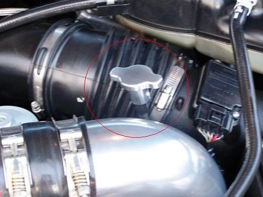

I solved this problem after mine broke with an aluminum billet handle.
I had to buy another dip stick, so I grounded down the factory handle so it
would fit real snug in the replacement. You then tighten the replacement with an Alenn
wrench style set screw.
Great Mod...
Nice billet handle Bama; where can we get such a gem? Sweet Mod!
