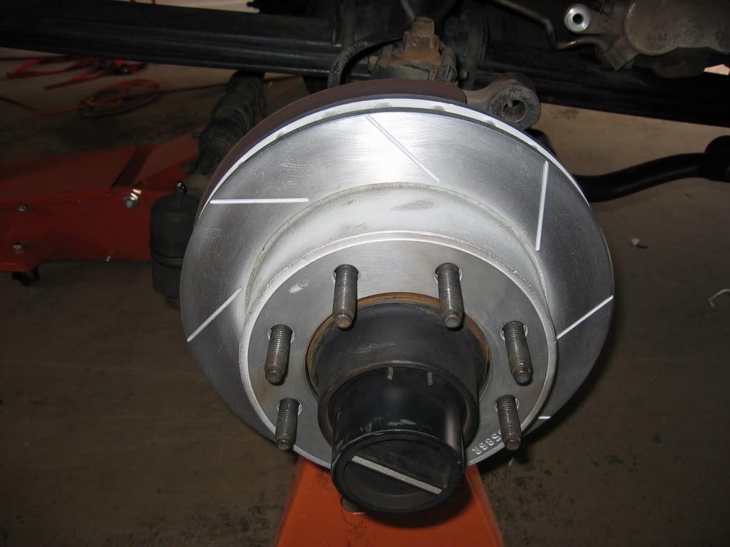

The new hotness :D :D :D

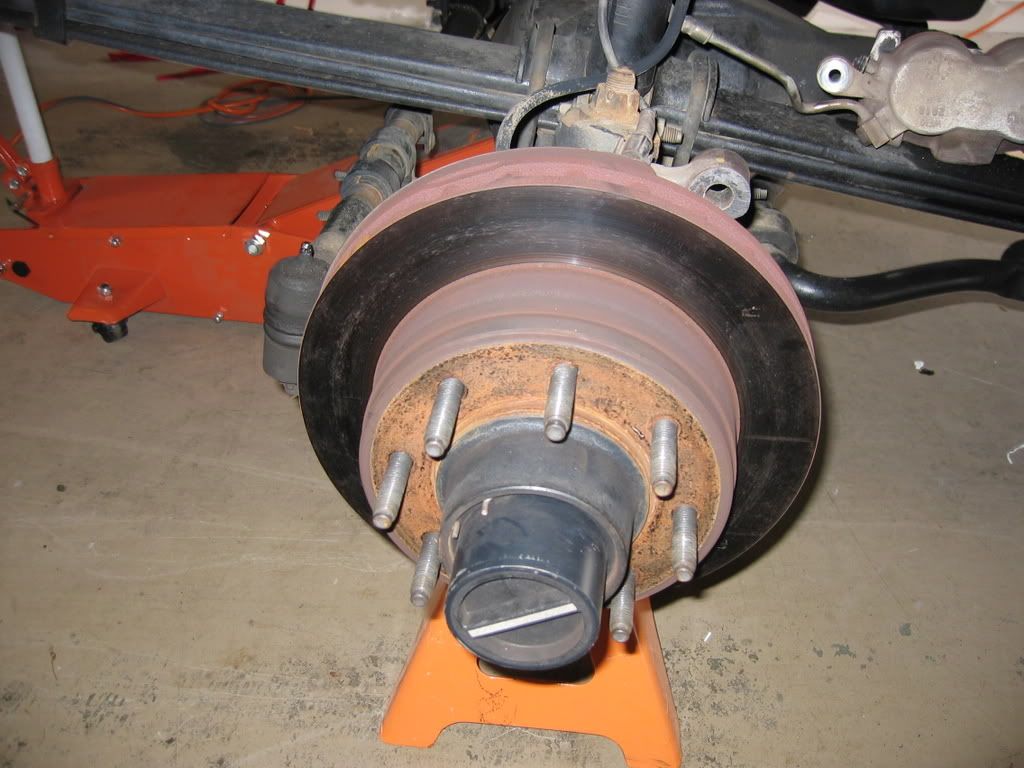

So...front axle goes up on jackstands, take the tires off, calipers, caliper brackets...and you get this:
and this
take your rotor off....pirate4x4? anyone? bueller?

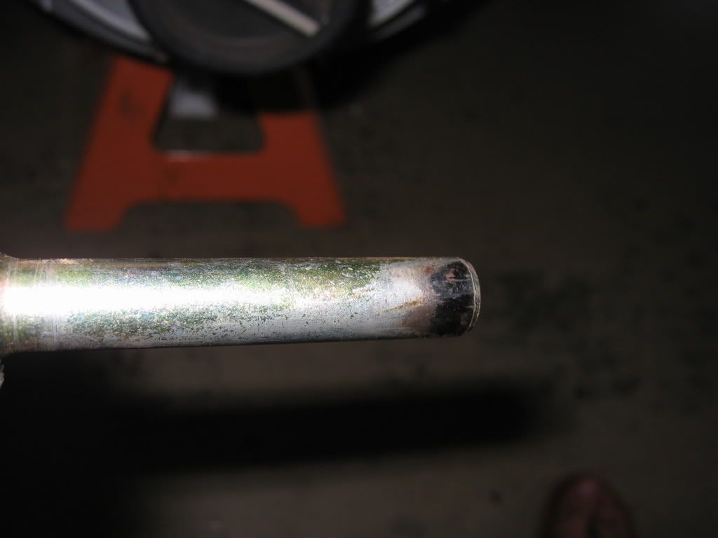

Here is a closeup shot of my caliper slide pin:
Its worn enough that I would have liked to replace it, but it was Sunday at 5pm and I already mentioned the 115* degree thing, so I greased it up and reassembled the bracket.

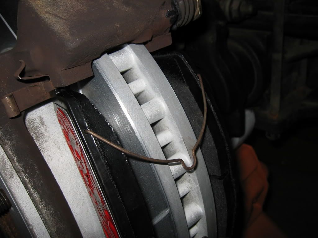

Reinstalled the bracket, put the new pads in with CRC disc quiet
little closeup of the pad-seperating-pins. These things made slipping the caliper back on pretty dicey with the quiet-goop all over the pads.

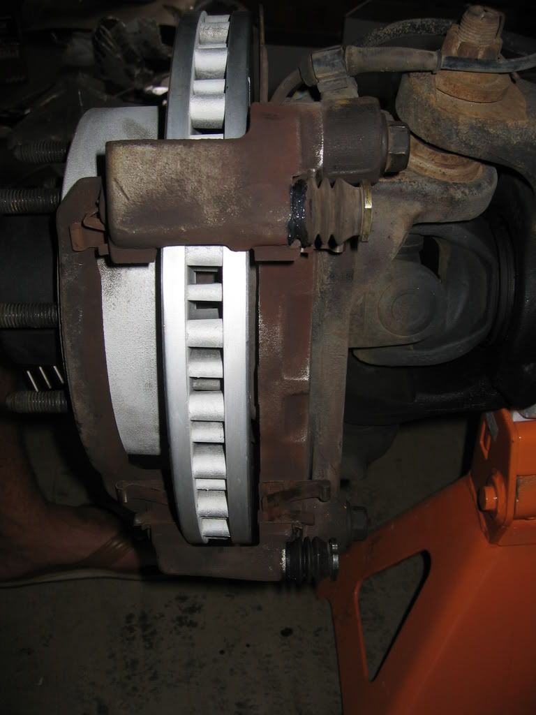

this is where i completely fell off the picture train. here's the last pic i got, of my rears with the caliper ready to go back on:
SO... looking at the pictures sunday night, I realized my rotors were on backwards. I never even thought to check to the p/n as I installed them. I'm not used to fancy directional parts. I busted it all apart again last night and fixed it, but since I removed the entire caliper bracket it took maybe 20 minutes start to finish.
