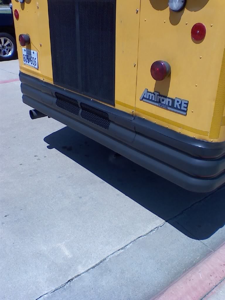

Wonder if the Racor filter could do something for this rear exit style open air CCV on this newer model bus?;tu
