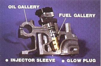

there is a copper crush seal that maintains the combustion environment and is one of the least likely components to fail. the injector o-rings serve to keep the oil in an appropriate location and the fuel in an appropriate location
Here is an image of the 7.3 injector in the head in cutaway
and a cutaway of the injector
and injector with o-rings
the internal o-rings are behind a check valve and would not impact compression tests. the external o-rings do not see compression pressures unless something else is messed up and then you'll have much more noticeable problems in the running of the engine.
You're going to take compression readings by removing the glow plugs or I have seen one adapter that replaces the injector but why you'd want to go to that trouble to check compression is beyond me.
