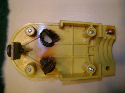

This was the 30Amp plug, on a 4' Pigtail between the RV park Service box and a Surge Protector.
A truck hit a Power Pole... everything went Sparky.. the Surge Protector tripped, saving the guyz Rig*... but the service box receptacle, this plug-in's Neutral lug burned off, and about 18" of the pigtail melted.
If One doesn't have a Surge Protector.. Makes One think about getting One :dunno
*On Edit: They Did loose one TV and a coffee maker.
