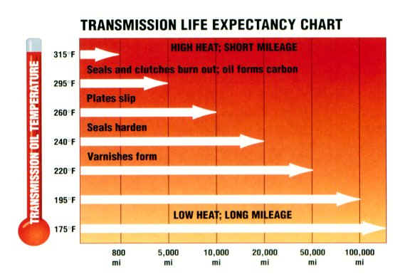

Longevity is related to lack of heat.
I run Redline synthetic ATF in mine.
