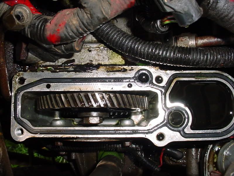

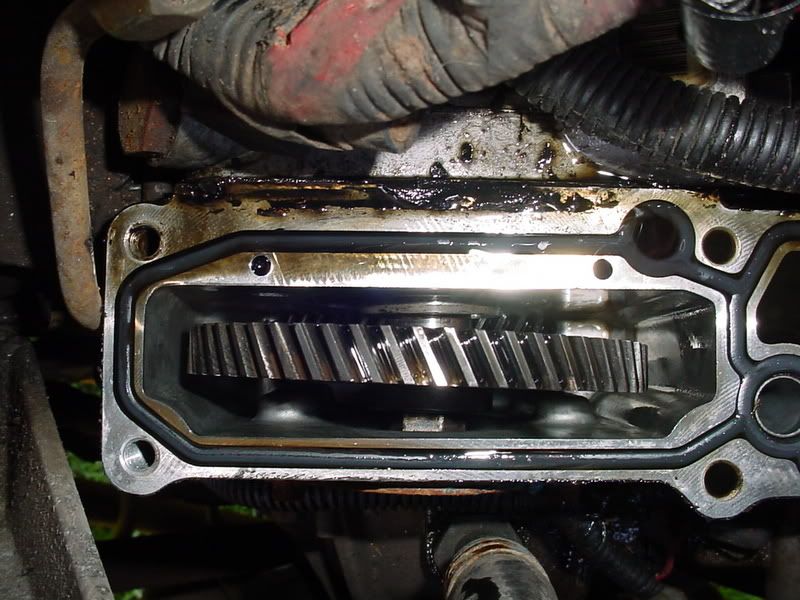

After a little cussing some tinkering help from my younger bro and a few calls through the phone network I figured out what was wrong with my $1800 PSD......
It was so flippin simple to fix...they I bought it from is gonna flip haha ......
From what I can tell the EXPERT Powerstroke mechanic that was workin on it before me musta been a dunce....
The gear that drives the HPOP was never bolted back up proper....it backed off and twisted the gear to were the teeth wouldn't catch.
So after two years of this truck setting and no one knowing wats wrong. A month after i bought it and 2hrs of wrenchin and this thing fired right up.
Thanks to Big K, Luke Cline, Darrell at dpppower, Dave and Jon(swamps diesel)....I got this thing singin I had to bend their ear a few times. Always helps to confirm what you are lookin at is NOT right
I'm so freakin happy right now.
Here are two pics first one is before the second is an after you can really tell the difference....
I can't believe it was so simple....
For having set 2yrs the thing runs like a frickin dream....I think it runs better than my 1995
