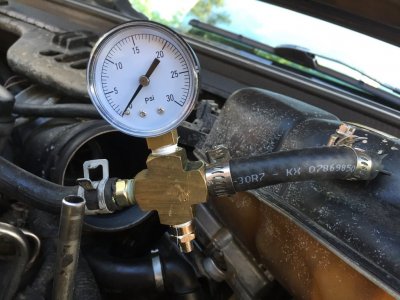

RandyH
Feb 24, 2008
262
Western Colorado
I just made a coolant system pressure tester for less than $20. Works great to chase down leaks (like the cracked injector bore I'm currently dealing with) but you can pump it up and hear/feel when the cap opens up to make sure at 16 psi. Pressurized through a Schrader valve on the bottom.
