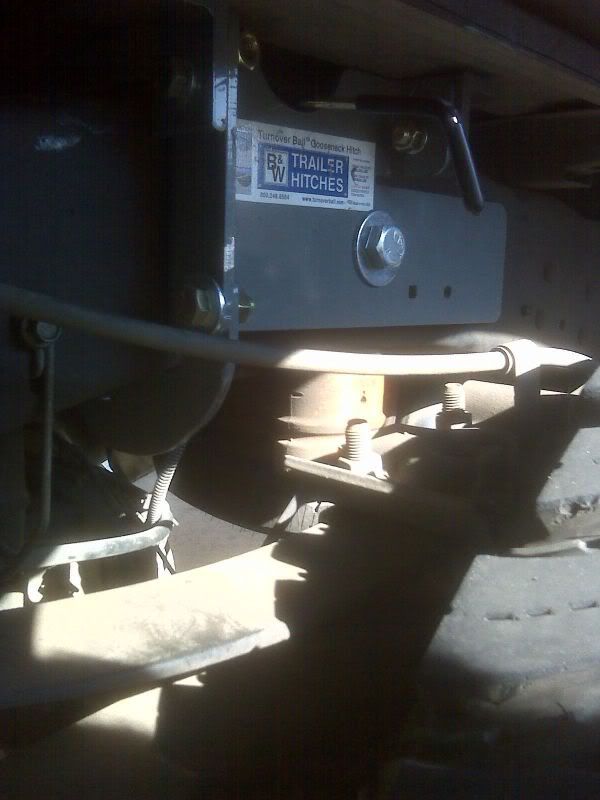

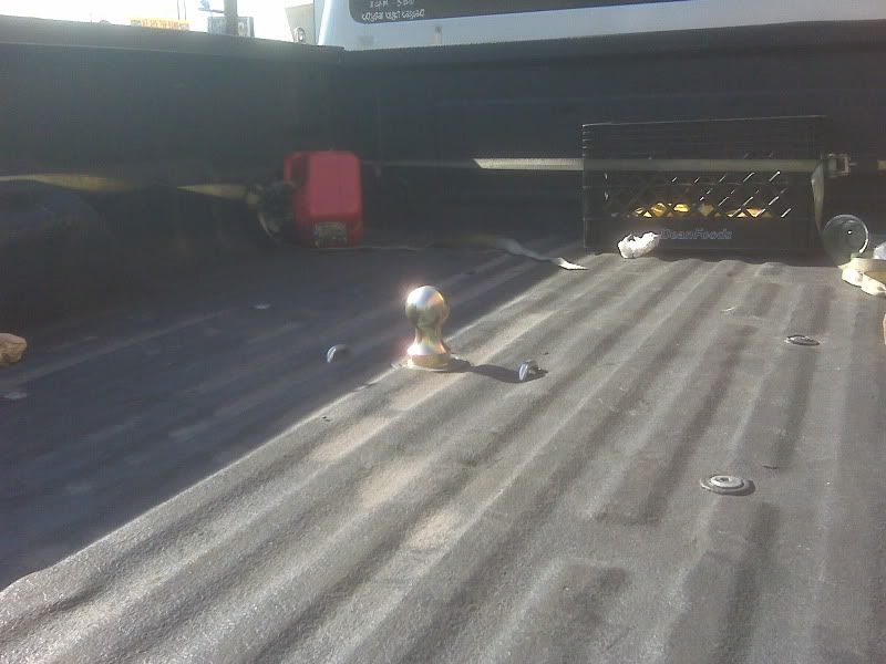

johnkid
Sep 15, 2008
133
CA , HERMOSA BEACH
heres them images Ponyexpress94 !
[/IMG]
