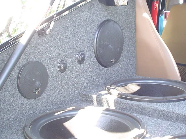

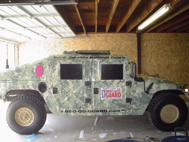

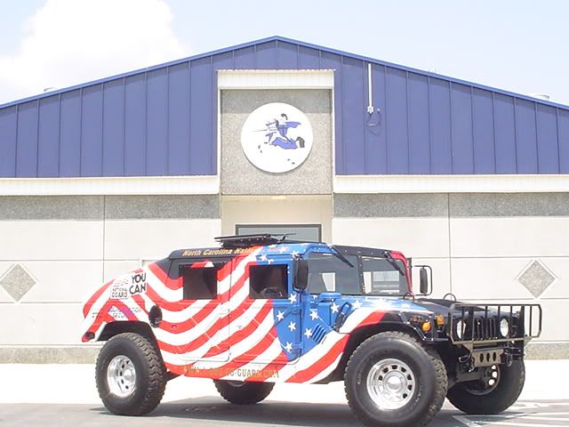

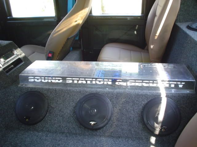

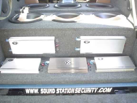

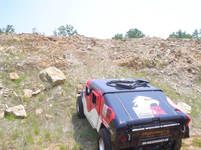

Just for fun ... here's a couple of pics of 2 of them. I don't have pics of the REALLY nice one yet, though (just finished it).
This one has (6) 15" woofers, (5) 1K amps, 10 mids, 10 tweets. All Memphis.
This one has different wheels now ....
