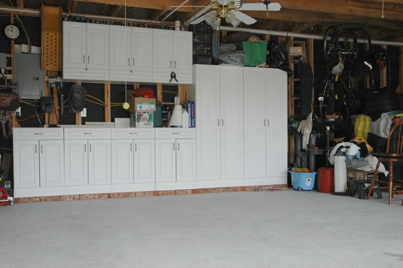

budro understand...
youd probably cringe at my garage wiring too...your points are
well taken by all & we know you only wanted folks to be as
safe as possible.
Bike wall (w/ outlets & chargers) ->
Cabinet wall (w/ outlets) ->
