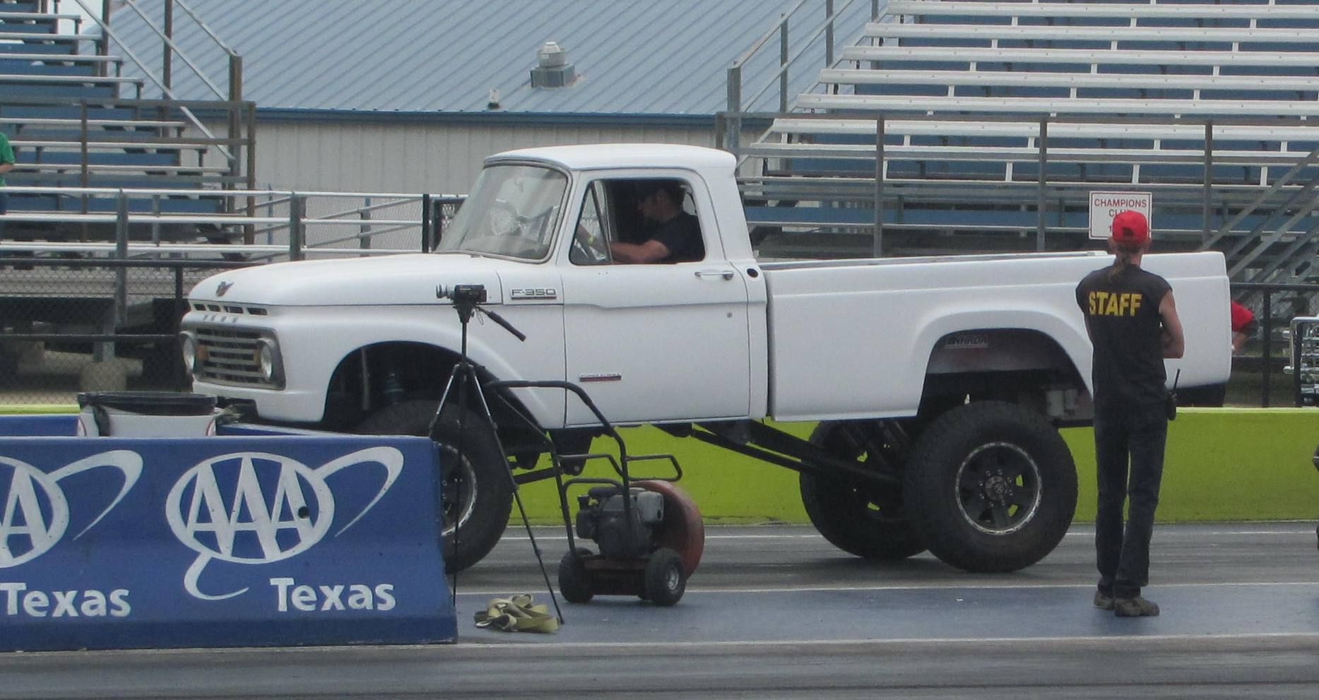

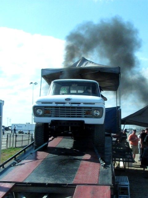

UPDATE 4/13/10 Texas
Well that was a rough trip, but well worth it. So it ran well but I have some suspension issues to work out. We mounted the bags wrong and I need to drop them. It only takes 8 PSI for ride height so if I want to stiffen up the rear it jacks the rear way up in the air. For the front the spring rate is so high that there isn't enough downward load so the roll center seems way high. By dropping the bags in the rear down and cranking the coil stops all the way up in the front I think things will be much more under control. So I think the next event is Sac. Back to work and I'll see ya there. Sorry for no real pics on the paint. I sent it back as soon as we got home. He did he wrong color, got over spray everywhere, and didn't even paint the insides of the doors.

The back bed looks like it came from a 1960 or older pickup. I don't think it matches the 1962 cab. :dunno

I don't get it either and I haven't researched it at all. Some say they came that way some say no but since I've owned it I've seen quite a few from the same early 60's era and they are the same way. I don't really care for the other bed style from the 60's F250 4x4s anyways.
