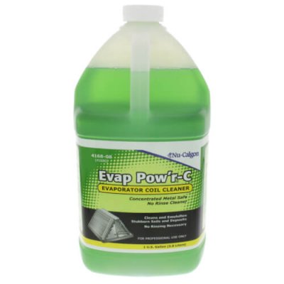

there is no secondary fan. if the inside is dusty, yes cleaning the evap coil and a good blow down of the vents or snaking a vacum is a great option.
NEWCALGONE makes a product that is a concentrate and you mix it up in a bottle to spry the coils and let it drain off through the drain hose port.
or you can buy it in an aerosol at lowes , etc in the a/c asile its called condenser coil or A coil cleaner
also the fan would need to be cleaned as well. you didnt say but do the dash vents blow strong? if so i would look for a blockage,
