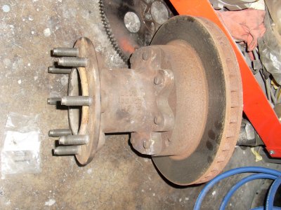

Dave is correct... the SWR and DWR trucks use the same front axle, but have the dually adapters to allow the use of a single dually wheel on the front locating the wheel in the proper location under the truck...
A dually that left the factory with a pickup box from the factory, uses a completely different axle than the SWR trucks. (Actually there a 3 different axles, a Cab & Chassis axle that could be SWR or DWR, a SWR axle that had a pickup box from the factory, and the dually axle that had a pickup box from the factory.)
There is something like 6" difference in length between a DWR and SWR axle, a dually axle is ~72" wide, and a SWR is ~66" wide.........
Yes they do make adapters.... many have run them for years.... but if I were going to do a conversion.... I would get the correct axle.....

Check out LMC trucks out of Kansas for the dually fender extensions and Arrowcraft for the wheels and spacer conversion. Google search srw to dually conversion kits.
