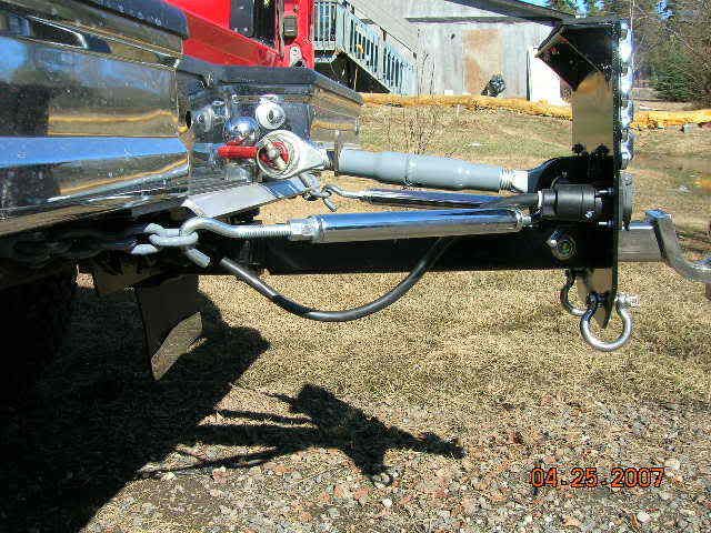

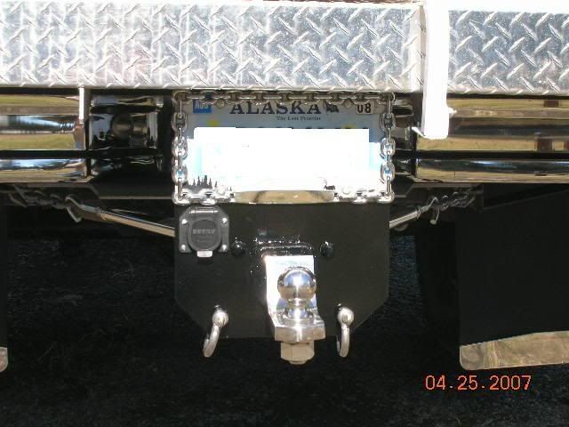

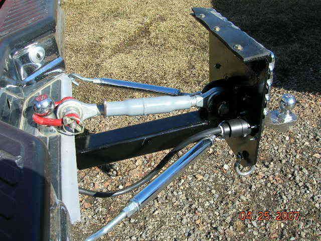

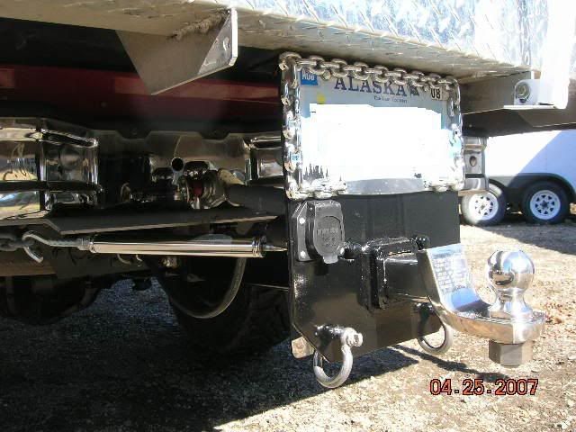

Stroked, you should be able to find something here, may have to look for it. A few years back I had one just like Joe was telling you about. They work great if you have a cabover camper and don't over load your truck.
Hitch Adapter Hitch Accessories | etrailer.com
Thanks Doug & Crumm, I was looking for a link, but couldn't find it.
Kinda hard to explain without pics/illustrations.
Crumm (?), you gota hellofa set-up. ;tu
None of the tongue weight was on my camper bumper however.
