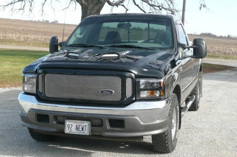

Can always go one step further and install 05-07 lights if you like that style. You have to due a little surgery to make them fit. Got mine off a seller on Ebay. Put the Harley lights on my 03. Put a set of Harleys on my 05 as well.

Now that I've seen a 99-03 fitted with 05-07 Harley lights, I'm thinking hmmmm. My truck is black too....

I'm going with the 05 plus Harleys, there is a seller on eBay that sells the conversion kit with install instructions. All for a 180
