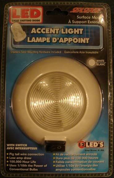

a few 12v lights for about 3 hours
I found out the other day that two of my 12v lights use more power than my furnace :eek: I did a little research over at rv net and found out that the best upgrade to fight against battery drain is LED lighting. I installed four Sea-Sense LED fixtures and have two more on the way. I also installed a led cards in two of my reading lamps. I can now turn on all these lights and have less draw than one of the factory 12v fixtures.
These are the led fixtures I installed available at bestcoverter.com
These are the cards I installed available at jclampstand.com
Spooky you should mention LEDs Crumm.. I've got 6 of the 36 LED cards on the way myself. I'm trying to get as Bulletproof as possible with all the needs for our 4+ month RV Road Trip. LEDs everywhere I can plug'm in/hook'm up.
So Far.. I've converted the 350 Inside & Out. The 5r exterior-wize... work'n on the inside.
On past "Vacations" we've stayed in the occational Rest Stop and Wal'Mart P-lot sooooo anything Low Draw is a Good Thing, IMO.
Thanks for the Link to the cards, I'll compare prices. ;tu ;tu
