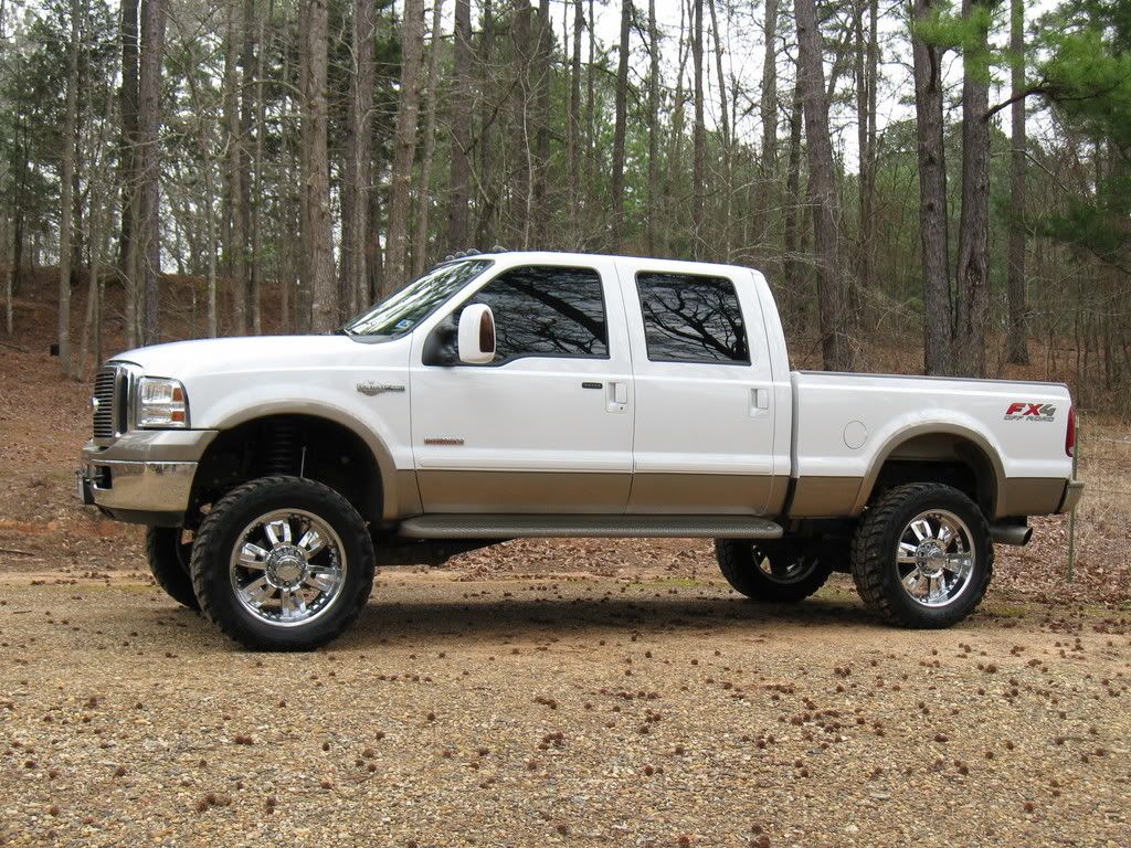

Hey bears4x4, go look at "My night job" post it has the last truck I lifted in there. The lift is a RIZE lift in the front the back was a fabteck. There not cheep but it's the most stable lift, I have put in a truck. If I was going to lift my truck I would use the RIZE lift. It's cost $$$$ and it's a pain to put in, but the ride is great and it's a good look on the truck. Does not look like cheep backyard lift work and I'm not saying fabteck and other lift a cheep guys.

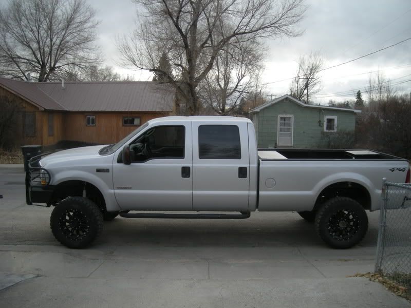

Can i put 35/12.50-16 under my truck now with the stock height? im needing new tires now but dont have all the $ for the lift yet
YES, You will need to put a 1" spacer in the front bumper and cut some metal out of the way in the front wheel fenders under the plastic wheel covers down by your feet.
