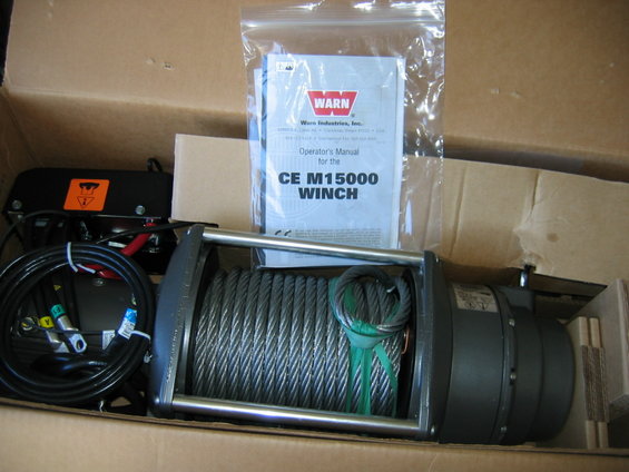

Warn makes a WARN WORKS® 4700 DC that is designed to do what you are wanting to do but with the loads you haul I would recommend a M15000. The 4700 will pull a rolling tractor but there will be the day you will need to load something that doesn't roll ;). If you are wanting to save a buck or two you might check into the Tabor12K, it is built by Warn but comes with a more economical price tag.
