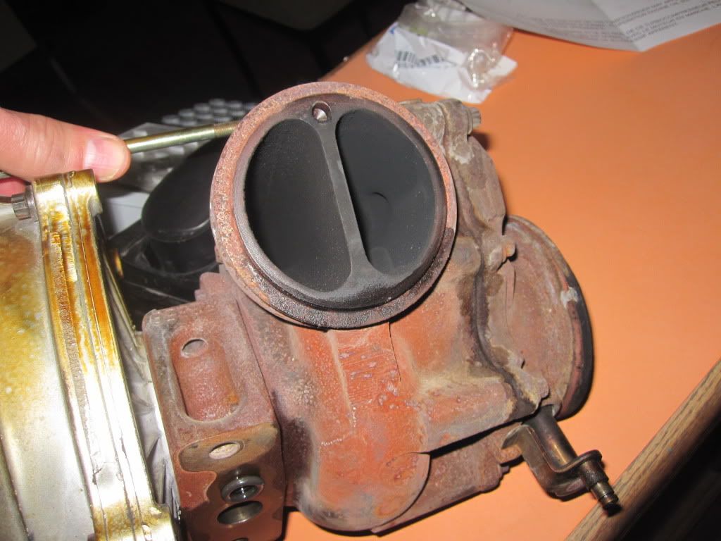

here's what the exhaust inlet looked like . I had the engine hooked up to a computer and they say #8 injector is showing a problem. I guess that may be my next step . ( new injector )

lets back up a bit.
1. you are seeping oil at the piping joints at the boots. that means that the oil vapors in the system is condensating out and running on the insides of the pipes until they hit the joints. the oil collects in the crevices and through capillary action wicks out. EVENTUALLY the seal of the boots is broken and then the pipes get oil wet. the oil collects dict and the whole thing looks like a mess.
2. on the 7.3 the source of the oil vapor is from the blowby in the engine that is vented through the CCV into the the fresh air turbo inlet pipe between the air cleaner and the turbo. i am guessing that you saw that connection in removing the turbo.
3. if you are oil wet at the turbo pedestal it could be the pedastal o-rings that went bad. only one of them is visible in the picture you posted. the whole thing looks wet though it might be due to removal.
4. what if any axial and radial play do you have in your turbo, old and new ones?
5. what is the code you are getting for #8 injector being bad? #8 is NOTORIOUS for many other reasons, when in fact it may truely be ok. who is 'they'?
6. how often are you sitting a long time at idle? are you using an idle controller? you might be wet stacking. google it.
