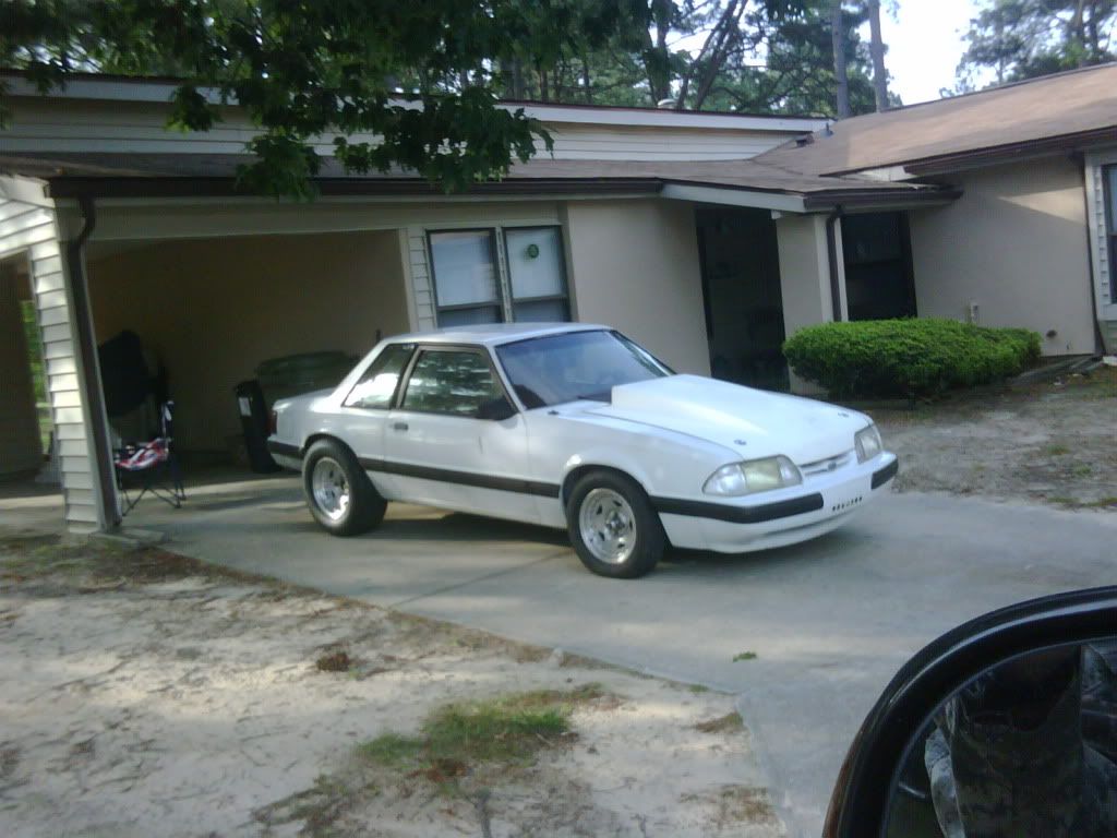

I decided to pickup a new project. Here are the Basics: 1987 Mustang Coupe. Has a 351W bored .30 over (358ci) C-4 trans. Victor Sr heads. BBK longtubes. Eagle crank and rods. Holley 750 with Mech secondaries. Victor Jr intake. 175 nitrous cheater. Frame connectors. Auburn 8.8 locker with 4.10's.
Have some additions ready to install: Tubular K member. Tubular control arms. Adjustable camber plates. Quick ratio manual rack. strange engineering adjustable struts. Lakewood traction bars. Comp engineering adjustable drag shocks. Moroso drag springs. MSD Distributor, Coil and the new 6AL-2 box :hail. 7 quart Moroso deep sump pan with high volume pump and windage tray. Ford Racing tall valve covers. Line lock. Trans brake with full manual reverse valve body. Deep tranny pan.
getting ready to order some more gauges once I figure out where I want to mount them. I am thinking I will get one of those kits that eliminate the the the center vent and holds three gauges.
The car has slips saying it runs 6.90 in the 1/8 on the bottle and 7.30 in the 1/8th on motor. I am hoping for high 10's low 11's in the 1/4 on the engine. The car will be a race car you can drive on the street vs a street car you drive on the track.
Unfortunately I have no idea about the cam profile or the compression of the motor. Not a big deal for right now but I would like to know ( I will figure it out)
I will update the progress, hoping to have the motor and suspension done in a month or two.
Paint and interior will come next year. Of course I have purchased new door pins to cure the cursed Mustang door sag

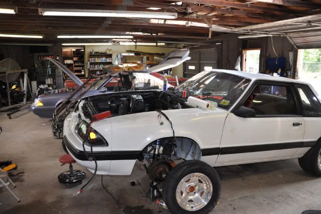

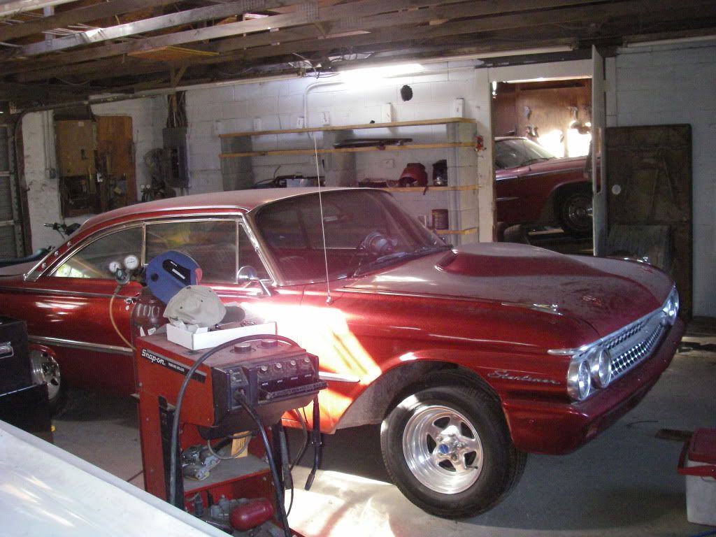

Here is my buddies 61 Starliner that we are dropping a 521 in :dizzy

wanna sell the Pontiac?
Whoa! Pontiac? That is a Ford only shop. The 61 is a Ford Galaxy Starliner and the one in the background is 63 Ford Galaxy 500.
I didn't realize the 63 was in the picture because it is in a different bay now. We are finishing up the engine install in the that in the next few weeks. It had a 352 in it but it will soon have a very nicely built 390 with a C-6 and a 9 inch locker in the rear. Will be a good cruising car that will make some guys with "hotrods" feel bad to be beat by a 6000 pound car.

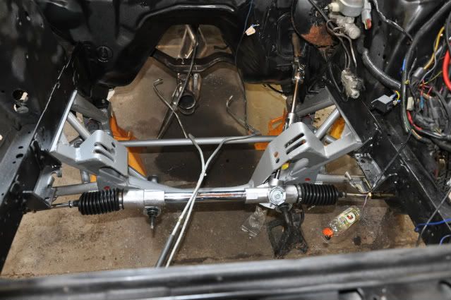

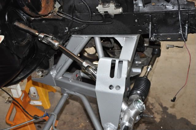

Here are a couple more pics of the progress. So far everything is out and I am waiting for my brass freeze plug set to get here to take the motor to the machine shop, should be here weds.

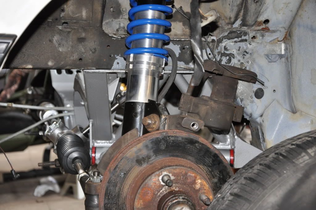

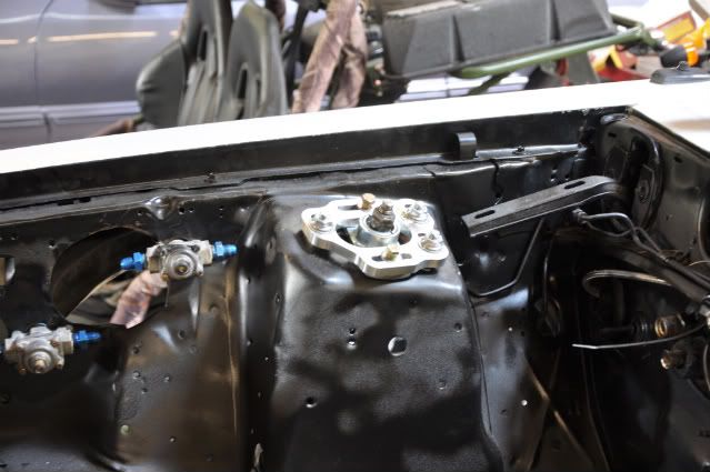

The tubular k member, control arms, coil overs, struts, adjustable camber / caster plates and quick ratio manual steering rack are in! :clap:
