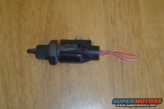

I've never done it before with a super duty but: When I did it in my bronco I used a ford explorer overhead console it still had the pig tail on it and I wired it up, you will need the sensor for outside temp looks like this:
The only things that worked were the time/compass and outside air temp and lights. The liar meter or miles per gallon and or miles till empty didn't work. I didn't want to hack into any harnesses to make those work.
