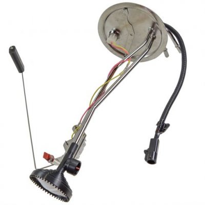

How long did you have fuel pressure gauge on it? You really should have a permanent one to see what the pressure is when it acts up and also to warn you of possible, imminent, catastrophic injector failure due to low fuel pressure. Blue spring mod is one of the first things done on all 6.0's I have and had, even the one with the plugged p/u assembly had it and still presented same issues. 65 psi is very good, it will fluctuate from 50-65 while driving depending on load given and it will eventually settle around 60 since the spring is new. Not 100% on stiction being the cause, I still recommend pulling the pickup assembly since it has never been done.
5k on injectors and already having stiction doesn't seem likely, I seriously think you have a fuel supply issue. Since you already changed the HFCM, injectors, filters there's only a few things left, that pickup assembly being 1, HPOP system the other.

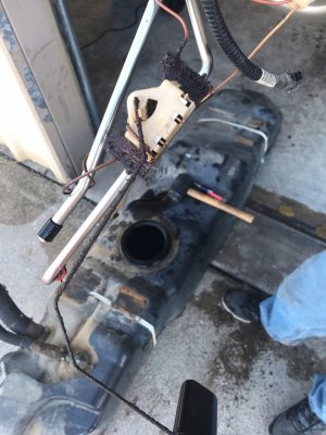

"The lower Racor filter, when looking to the inside had brown lines creeping up the filter ribs" That brown stuff came from the pickup assembly. It's the only metal in the fuel tank and even though it is stainless it still corrodes.
"And something else to add, this rig sat most of the winter and wonder if that created a settlement issue" How much fuel was in it when sitting? Anything under 3/4 tank and that pickup assembly is exposed and gets oxidation worse then it already had. Go back to my post with the picture and look at the "brown" stuff on the assembly.
