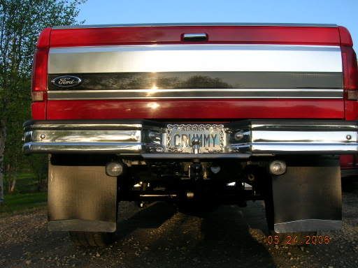

Did my annual spring cleaning today before heading out to the river. Any of you guys paint underneath or am I a nut like my wife tells me? I paint the undercarriage every two or three years. I just blast it off real good with the pressure washer and let it dry for a couple of days then shake-em and shoot-em. Seems to keep it rust free. Have probably did it a three or four times since the truck was new. It is amazing how much of an improvement $10 worth of paint makes. I shoot the axles, springs and frame. I use Krylon Rust Tough Enamel. I use Gloss Black for most of it and hit a few details like the shocks and sway-bar links with battle ship Grey. The Grey is the same color that Trail-master puts on there SSV Shocks.
Stop rust before it happens. Spray Krylon Rust Tough Rust Preventative Enamels directly on your metal surfaces. It chemically converts any rust formation to a black waterproof primer. It stops future rust from forming and dries to the touch in less than 30 minutes. No primer needed!
Under the Front:
Under the Rear:
Side:
All done and heading out :sweet

Now that is a little bigger project than I did. I have never painted the red part under the truck just the black stuff. The underside of the cab and bed still look good. I just wash and wax them a couple of times a year. I go the wash and wax route rather than undercoating. I have a 75' that was undercoated when it was new and water got in-between the undercoating in a few places and I caused some rust. In other spots the undercoating did not adhere good and peeled off. In the peeled off spots the paint looks good with no sign of rust. I think the undercoating might be a good idea in some places but not here.
Just for the record to make sure I don't get in the "nuts" category when I wash and wax the underside of the cab I wash at home with my pressure washer and a brush and do the waxing at the coin operated car wash in town. I hit the little button that says "hot wax" and spray the heck out of it. I don't get under there with a applicator sponge and a bottle of wax. :D
