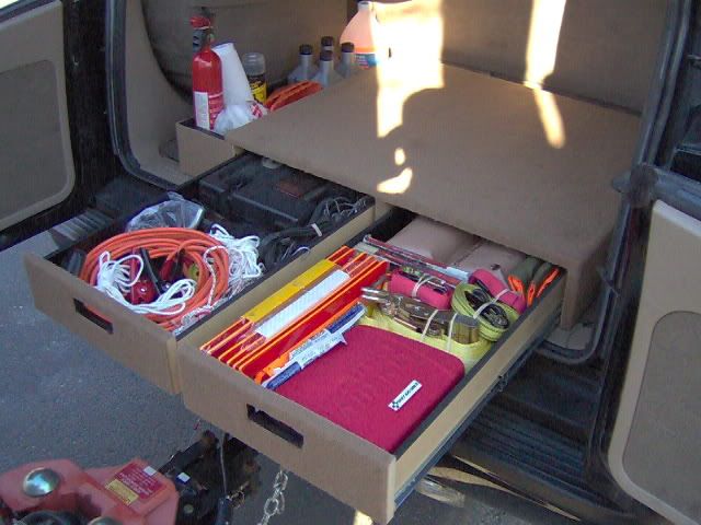

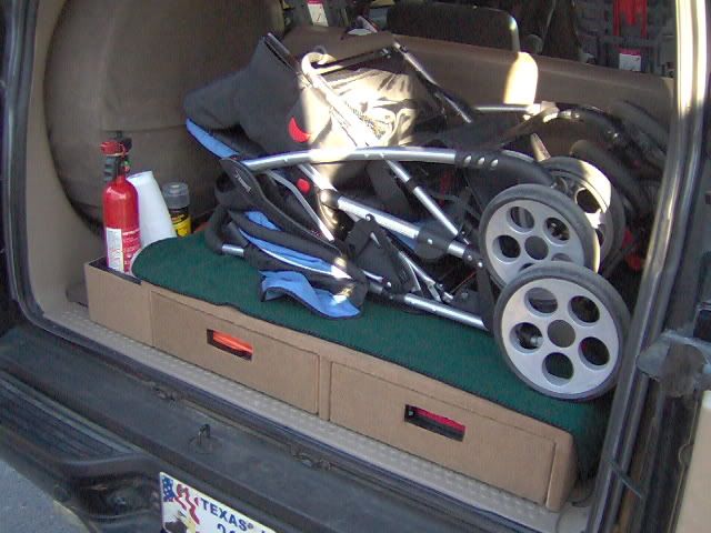

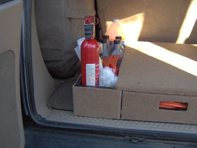

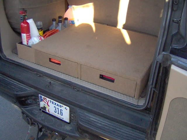

I had the same dilemma, so here is what I built:
I covered it with automotive carpet at Walmart ($8). The drawers and storage bin on the left are sprayed with the same stuff used to seal pick up beds, so they will hold liquid if some is spilled.
The tray on the left side is for extra oil, fluids, and any thing else that needs to stay upright. There is still room to get the spare tire out.
I can open the right drawer with only the right barn door open; it's got all the "emergency" stuff in it.
And it's strong enough that I can stand on it (250 pounds). As for the 4x8 sheet of plywood, you can fold down the rear seat and lay it on top. Works pretty nice.
Hope this helps spark your imagination. :thumbs Total cost was about $80 (the full extension drawer slides were about $40). Oh yeah, it's anchored in back to the floor anchors so it won't tip out with both drawers extended.
