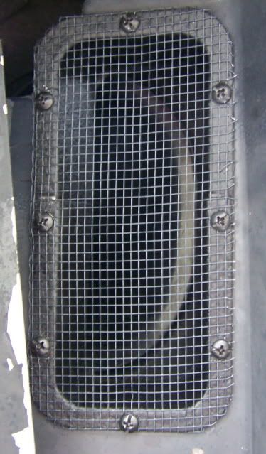

    The Zoodad mod itself is all about getting more cold air into the intake,
    but alot of us have "dressed" it up a bit to add some style to it.
    This thread can also be used as a good resourse so new members
    can see what the Zoodad is and how they can do it.
    So post up pics of your "twist" on the Zoodad mod. :sweet
    The Bama Downspout Zoodad Inlet/Grill
    [​IMG]

    Is that the final one, bama? Didn't I see an earlier post where you were making one out of heat register and a vacuum hose or something?

    That's what I have on my truck now, the one I am
    working on is kinda just for fun to see how it would work.
    Scroll down to post #19 and you can see some pics of the one I am working on.

    Mine's just a hole with the airbox snout shoved thru it. Covered with several layers of screen and a few zip ties to hold on the screen. I'll post a picture. Pretty simple but pretty ugly.

    EGT's dropped. Stock set-up or aftermarket still has intake dead-ended against a fiberglass wall. Your engine is breathing what it can from under the hood.

    King0581 Full Access Member
    Messages:
    248
    Likes Received:
    Joined:
    Feb 13, 2008
    Location:
    Monroe, VA
    The King style zoodad.
    I had the pieces laser cut. The material is all stainless steel. The louver had to be custom made to fit the application. Then I had to go to work with a hammer on it. The piece that the louver slides into has 4 M5 studs welded on the back that are 1" long(my advice is to go as short as possible because they can be a pain to start the nuts on). Its just basically like a sliding storm window, the way its made. Then I have the piece that I put behind the fiberglass cutout that matches to it to keep it from pulling out and to make a better seal(I sometimes over do things:dunno). I also have a solid piece that I can slide in place of the louver if the need ever arises. If anybody does a setup like this make sure you make your cutout and drill your holes low enough to be able to swap the pieces out easy.:doh: . View attachment 7724

    Thats some sick (in a good way) stuff right there king. Awesome.
    Most functional I have seen.
