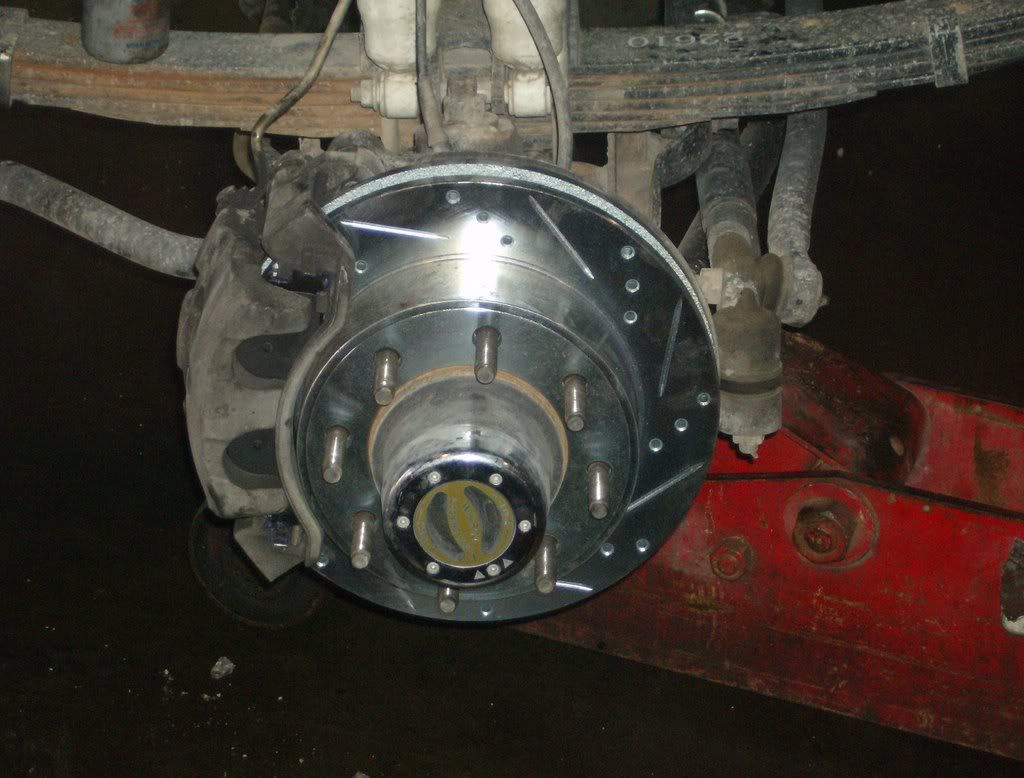

this is the passenger side abs plug-in...it goes to the hub...........
it is NO light hook up...
i just realized that i should go take a pix of it 'at' the hub so you can see where it 'might' be plugged into on yours..give me a bit...:innocent
here you are. you can see from the fourth pix where it would be bolted to the knuckle and where it would bend down into the hub.
the last pix is of the old one and how it looks...
hope this helps...not sure why yours is missing your abs line...:eek::sorry as long as your truck was capable it should have one...:doh:
good luck w/ investigating...

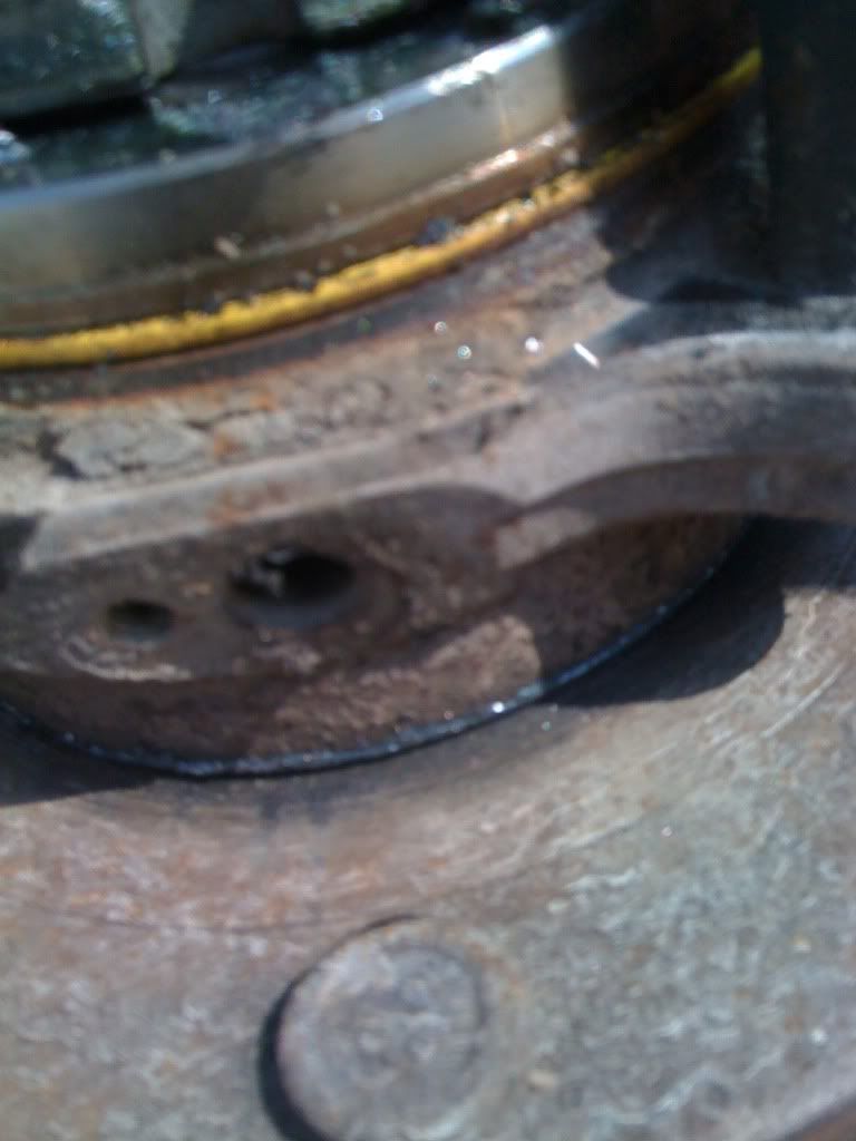

Its abs sensors. Look at the hub that i gave you there is a hole with a threaded hole next to it that is where the abs sensor goes. On the top. Damn i'm good had a pic of both on my phone.

Hey crackhead if ya have abs with auto hubs you'll 2 count em 3 lines going to behind yer wheel. One vacuum line, one brake fluis line, and the abs sensor. Whip out that crappy blackberry and take a pic behind the wheel.

thanks for the pics Red and Rooster, i have manual warn hubs, i looked and saw no holes like you showed rooster and no other lines like in the pics red other than my brake like, ill clean up my hubs tomorrow and keep looking, it would be weird to have the plug but no abs sensor in the front unless the former owners changed out the front end like that????? at least i have reference pics to go by, thanks guys :sweet
