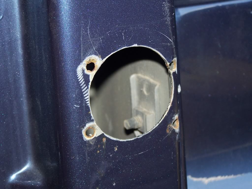

This is the hole that was left after I removed the 7 pin receiver.
I removed it last year when I decided to take out the 5th wheel out of my bed.
(I would have never put it there, but that is where it was installed when I was setting my truck up to pull a trailer.)

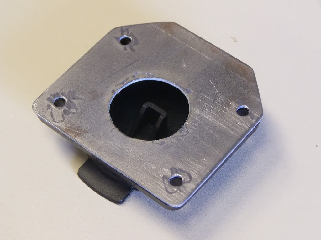

I bought a cheap 7 pin receiver and cut the cover away from the wiring harness. (basicall just needed the cover for cosmetic reasons)
Here is the cover after the surgery.
Here is the new plate I fab'd up to hold the 12v plug-in and to cover the big hole.
A little paint work (med. wedgewood blue in a spray can ;tu)

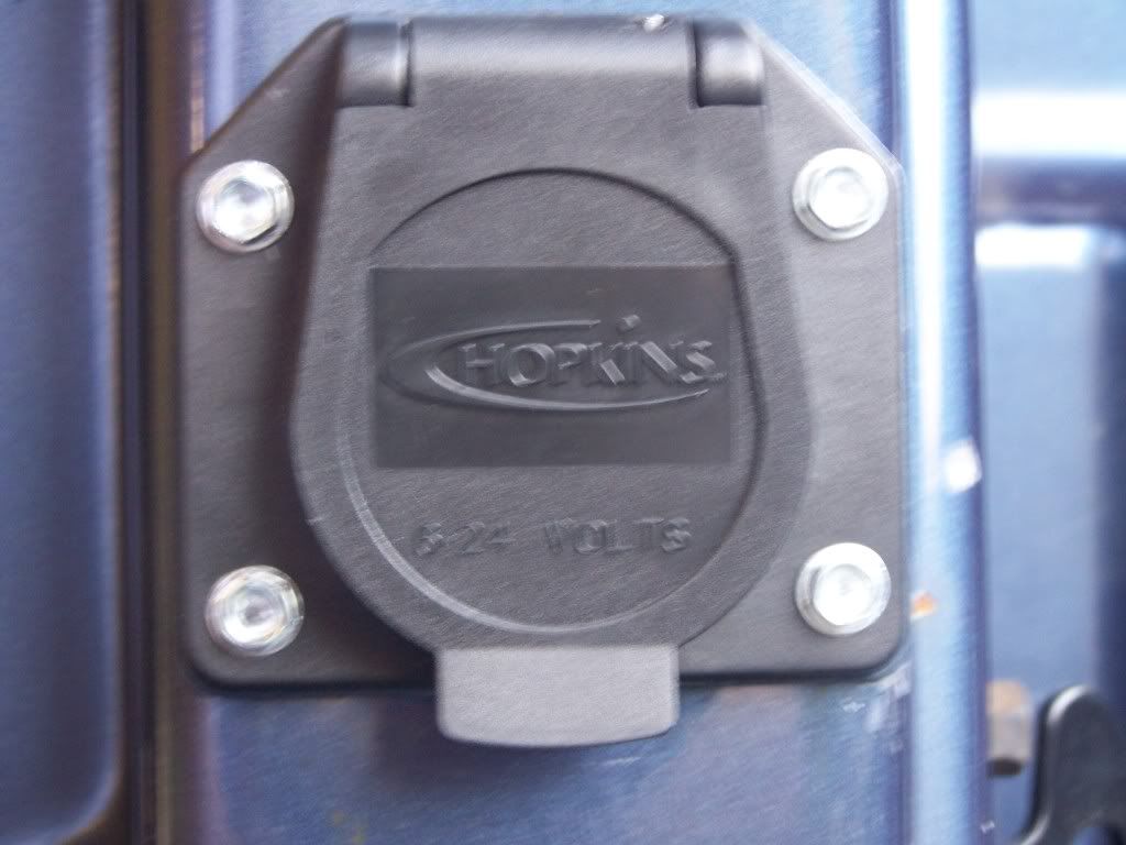

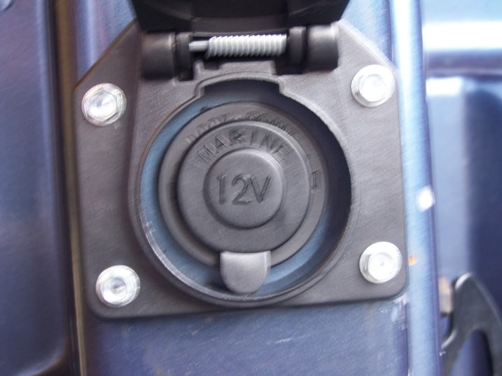

The final 3 pics show the final results.
You dun good Bama.. Real Good, Great Job ;tu ;tu
Looks like a commercially manufactured Power Point :sweet

Very nice work! Great idea on the using the 7 pin cover and nice fab work on the plate. :sweet:hail
I didn't really need one in my bed but since I have seen what a good job you did, c'mon over and do mine. :D
