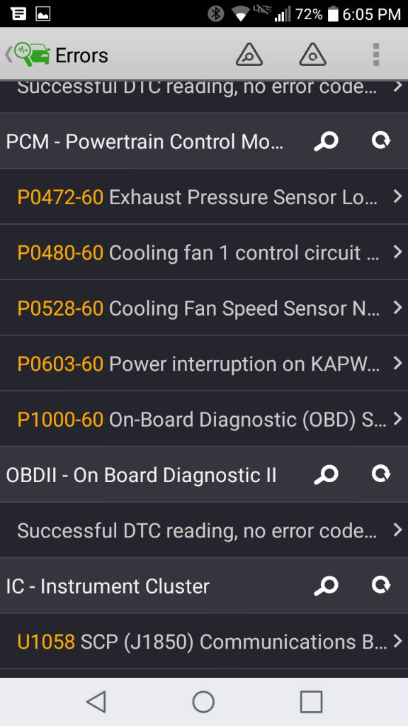

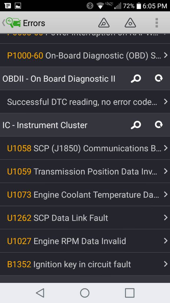

Okay, I actually downloaded the Forscan demo (free version) I like it I might have to pay for the full version, and no out of the ordinary codes.
Just the ebp sensor code because I tried unplugging it and the fan codes are from running the mechanical fan clutch

I think those instrument cluster codes are out of the ordinary. Especially rpm code and transmission position. The instrument cluster plays a bigger role in the PCM processing than you would think.
But could those just be from having the key on engine off?

No.
Next step is v-reference check.
Okay well that will be tomorrows check and same with unplugging the MAF after the v-ref. Now for the v-ref should that be koeo and cranking and running?
