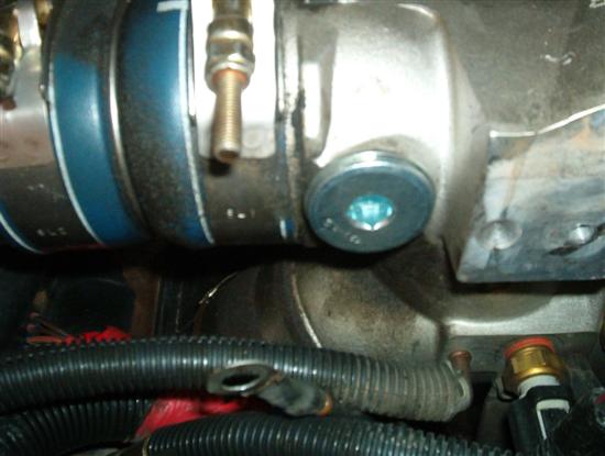

It's done now thanks to Bill for stopping by with resistor already assembled. Nice X by the way. I took a few photos of the resistor install if someone wants to add them to the WIKI since thats a little over my head. Bill I ment to get the part number from you on that upper hose, and I'll let you know when I'm ready for the "shim" help.
http://community.webshots.com/scrip...D=387169736&photoID=397510671&security=BMoMWZ
http://community.webshots.com/scrip...D=387169736&photoID=397511106&security=ulTZzQ
http://community.webshots.com/scrip...D=387169736&photoID=397511459&security=nsprQZ

Glad to lend a hand on the jumper wire for AIH,see if you can round up a length of plastic wire loom covering for the jumper as I didn't have time to pick up another roll ;)
The photo links you posted see if you can logout of your webshots account and re-post the public URL's :sweet

I dont know what you mean about the photos, you can't view them?

try these
http://image64.webshots.com/64/1/6/71/397510671BMoMWZ_ph.jpg
http://image62.webshots.com/162/1/11/6/397511106ulTZzQ_ph.jpg
http://image52.webshots.com/52/1/14/59/397511459nsprQZ_ph.jpg
