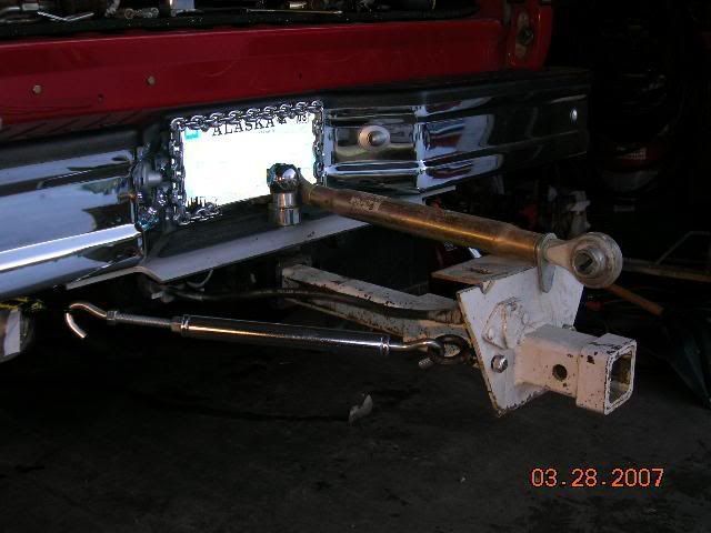

Here is a picture of the plan from the bumper thread:
With this design the tongue weight of the trailer will be transferred into a straight pull on the factory bumper which has a pull rating of 5000 pounds. The upper link is a upper link off a tractor three point hitch so it is stout. The upper link will also add a quite a bit of straight pull support.

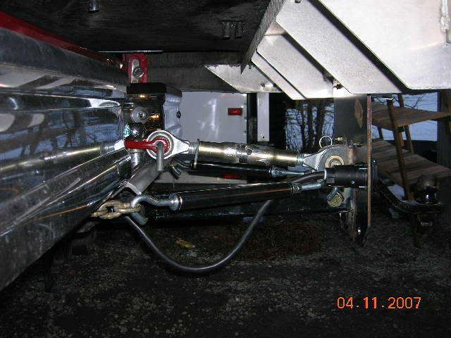

Here is the project about completed. I still need to weld it all up and then paint it.

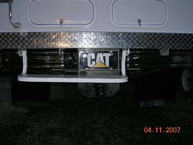

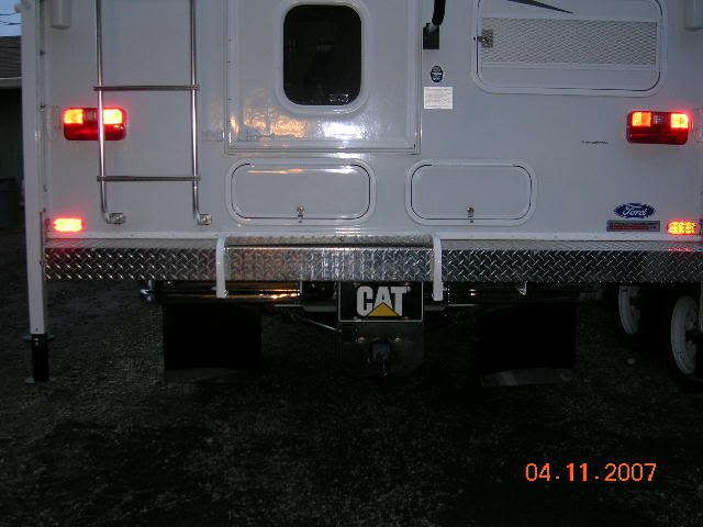

Here is the view from the back with step up and down. Notice it doubles as a license plate holder as well as a electrical plug mount.

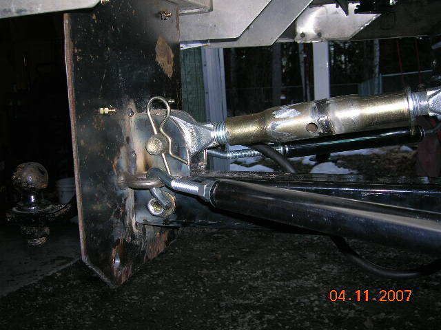

This triangulation of the extension makes it solid as a rock. Any constructive criticism before I weld it up and paint it???
Don't comment on the fact that I can't get the pin out of the rear end of the upper link due to the electrical plug in the way. It was designed like that to keep the pin in even if the clip falls off ;) Or I might run the pin in the other way after I remove the plug to paint it. :D

looks good crumm, of course, i have no knowledge with this kind of set-up, so no critisisms from me.
i like the CAT tag too. :thumbs
I use to have that on the front bumper and thought it would make a good pattern for the new hitch. I will have to move the CRUMMY license plate back to the extension one I get it done. Just a matter of four 1/4" screws but I wish there was a quicker way, maybe some 1/4" screws with wing-nut heads?

Crummy it look's real nice.:sweet One question though, is there enough room above the hitch ball to lower the camper step when the trailer is hooked up? looks kinda close in the pic.:confused:
Nope. When the trailer is hooked up the trailer tongue becomes the step. I would either need a drop hitch but then the trailer would be nose down or I would have to extend out farther but I don't want anymore than 18" so this is how it is. When I put in the WD hitch for my wells cargo it does have a 8" drop to it so the step will work but the boat uses this one.
