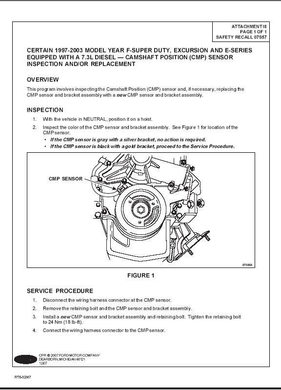

can you see this from your phone? tsb on cps replacment in jpg format.
http://i139.photobucket.com/albums/q310/centurycoronado/cpsTSB.jpg
if you are looking at the front of the engine, its to the LEFT of the lower pulley. its kind of in the V made by the left bottom of the water pump housing and the pulley. like 10 o'clock on the pulley.
(its on the right side of the engine in proper terms, but will be on your left when you are looking from the business end of the hood)
as far as where to get one- ford, international, truck parts. school bus parts. almost everyone should have something. steal one off a school bus with a DT444 motor!
in a pinch, you might be able to get by with one for the DT466. it ws the blue one that people reputed was 'better' but was inconclusive. but i think it would get you down the road if you had to.
good luck.

clint-
good luck.
Yeah i can see it. So it says if i have a Gray sensor and a silver bracket, no action is required. This confuses me. If i have this one, does that mean its not my cps?

info stolen from another site.
"The blue CPS for the DT466 has been updated too. The original update had them go from blue in color to a grey/black combo. The latest versions are now solid grey. But they still have a different part number compared to the grey CPS's for our trucks. I'm not sure what was changed in the update, if anything at all. So I'm not sure if it still affects timing or not. Here is a list I have for the original and updated CPS part numbers... both for Ford and IH:
94-96 original CPS: Ford Part # - 4C4Z-12K073-AB, corresponding IH Part # - 1821720C98
94-96 updated CPS: Ford Part # - F4TZ-12K093-C, corresponding IH Part # - 1821720C99
97-03 original CPS (black): Ford Part # - F7TZ-12K073-A, corresponding IH Part # - 1825899C93
97-03 updated CPS (grey): Ford Part # - F7TZ-12K073-B, corresponding IH Part # - 1876735C91
IH DT466 original CPS (blue): IH Part # - 1807339C92
IH DT466 updated CPS (grey)*: IH Part # - 1885812C91
*early versions of the updated one were grey and black, newer ones are all grey. These do not have Ford part numbers, since these are International engines only."
