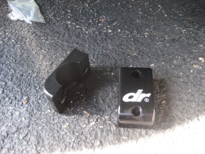

dual stabilizers are on the way...will have an update next week.

got the dual stabilizers on today...will try this weekend

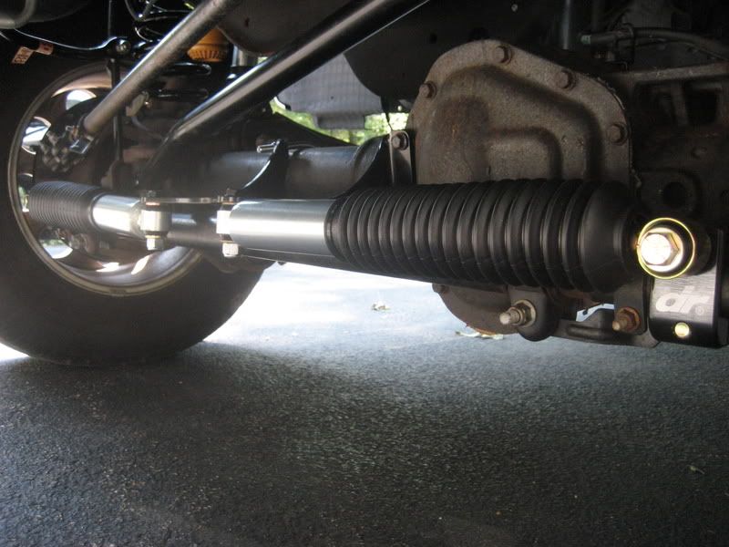

Yeap,
That is DEATH WOBBLE!!!
Another thing that can cause it is out of round tires...
ANY Straight Axle truck can have it to some degree.... ;)
Let us know if that solves it, if now, we can look at other things... ;)
6,354
Plano,TX
Nice kit! looks great:cool:
It appears like you may have stock tires,I'd launch those puppies for some premium ones. As Kevin stated,an out of round tire could be a good suspect,I had a couple of BFG TKO's that were out of round.

By chance did you put in a new drop pitman arm in when you lifted the truck?? If not, I see two problem in the last photo.
BADASS03SVT
Nov 17, 2006
51
Boston
no..the kit did not come with one as im told its not needed. it came with an adj trac bar. im told that for the trucks previous to 05.
what do you see wrong?
