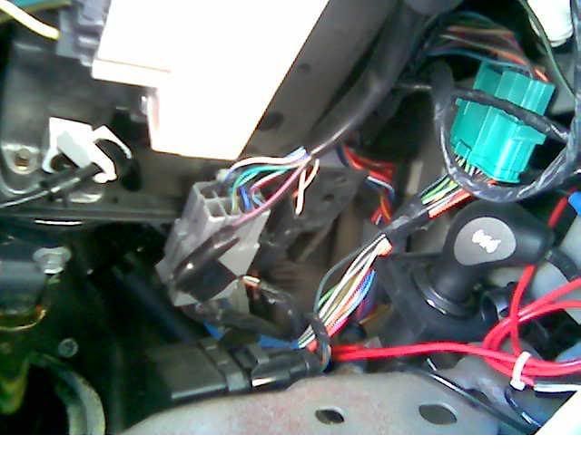

Ashmass,
I got my wires crossed earlier :innocent the one by the steering column was for the door/key chime...I disconnected the seatbelt chime under the seat...but there are other ways to get to the chime
here you go:
Door open w/key in ignition chime
Remove panel beneath steering wheel , on the right side of the steering column you will find a connector with a black wire and purple stripe.
It is easy to disconnect and remove the wire intact (tape outside of connector) or clip the wire and tuck it back into the yellow sleeve and no more annoying chime if you have the door open and radio on ect.
All other chimes stay working.
