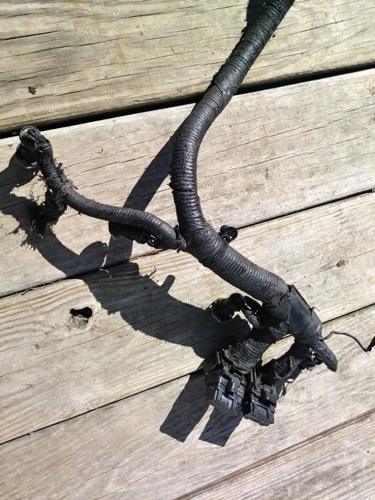

Well here is the ficm harness had a couple oil soaked plugs and one that is falling apart, guess it's time to replace it

Well I have solved the issues, installed new harness today after waiting for stupid UPS to deliver it yesterday.
It now will start hot no problem, so the issue was the FICM harness definitely money well spent
