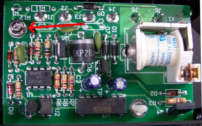

Here is a pic of the guts of the timer. Red arrow is pointing to the trimmer.

Thanks for the pic Bama. By the way would you recommend I go with the weld fitting or the band type thermocouple? My thoughts are the welded on fitting.
