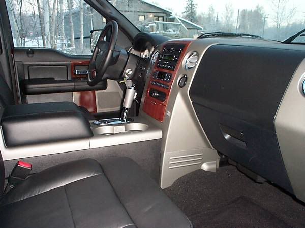

No need for remote control. Controlling at the iPod mini is fine. My stereo looks totally different that those shown above though. It is a factory six disk changer that says mp3 right on the front of it. There is a little slot on top that might be for something but it must need punched out or something? I have a fm broadcast thing that I can use but wiring in direct would be handier. The fm thingie is a little big.
You can kinda see the stereo in this picture.

Crumm, does your radio look like this one?
Ford AM/FM/CD-6 MP3 radio
If this is the one, the P.I.E. FRD04 AUX adapter and along with the Blitzsafe UII iPod adapter, which powers and charges your iPod while you drive, would be just the thing for you
