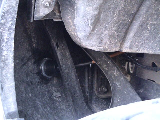

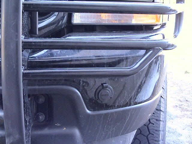

Here's a couple pics of my Marinco Plug install:
Front:
Back:
Tested for pullout and it held nicely! :thumbs :thumbs
Front:
Back:
Great looking install. Having it on the driver's side of the vehicle is sure easier to use. Since your bumper is black it looks great. Mine is grey and I did not want to use the bumper... so I went to the lower air dam which is pretty thick (for anyone else considering).
This site proved to be very helpful.
Yeah, I'm not sure I'd have put it in the bumper if my bumper wasn't black. Guess that's one of the few benefits of a black truck. As you can see, it doesn't stay very clean up in the snow belt.:eek:
On edit: I also like the Marinco setup because plugging and unplugging can be a one hand operation. Before I had to drop everything to plug it in. Just thought of that.
