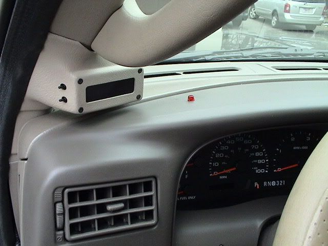

I finally finished the rgdillon mod. The only thing I had left to do was add the LED inside the cab so that I'd know when I was plugged in. Got 'er done today despite the bitter cold. I originally wasn't going to do the light since the Marinco provides good pullout protection, but I decided to add it as an extra reminder I'm plugged in and also so I can look from the house to the truck and see if I plugged it in (and the timer on the cord is on).
Here's a picture taken at night--hope you can see it okay. The light is mounted next to my X-Monitor. :thumbs

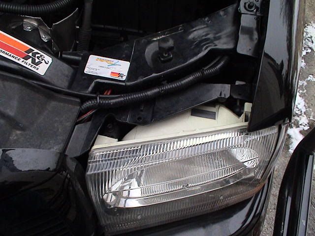

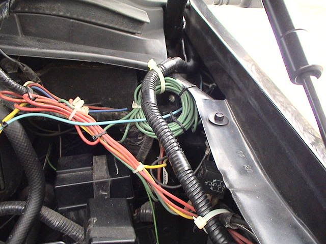

Actually, it is that easy. But there were a few precautions taken simply based on the 120V wire.
First, I purchased a 120V LED lamp at RadioShack (sold in 2-packs for about $3). Then I purchased 10 ft of 14 guage wire in two different colors. I also picked up some plastic sheathing (is that what it's called?--see photos).
I hardwired the 14 guage wire into the positive and ground wires of the Marinco plug, then wrapped the wire in the plastic sheathing and taped the sheathing at 4" intervals to keep the wire protected.
The wire must then be routed into the cab somehow. I chose to go up the bumper, adjacent to the drivers side headlight, and around the edge of the engine compartment.

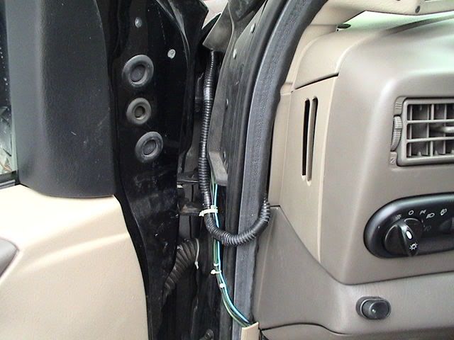

Instead of going through the fire wall, I chose to run the wire around it and in the cab through the door opening. This may not be the best choice, but it's worked for all my auxillary lights and leaves the wires accessible for future repair.
After coming through the door opening, I popped off the plastic molding and ran the sheathed wires into the LED.
I mounted the LED near my X-monitor for easy viewing from the drivers seat AND from the house to see if I plugged it in and it's getting power.
When placing the LED, remember you've got to be able to get a drill in there to drill the 9/32" hole. The sheathing was used to make sure the wires didn't rub on something and let that 120V screw the whole trucks electrical system.

you dont get water leakes going around the door seal? you know right above where your wires enter,... that black plastic panel... gently pop it off there is a BIG hole behind it that lets you in the cab. i found mine by accident.
the tubing i believe is " convoluted" . I am on it now radio shack inbound this afternoon.
